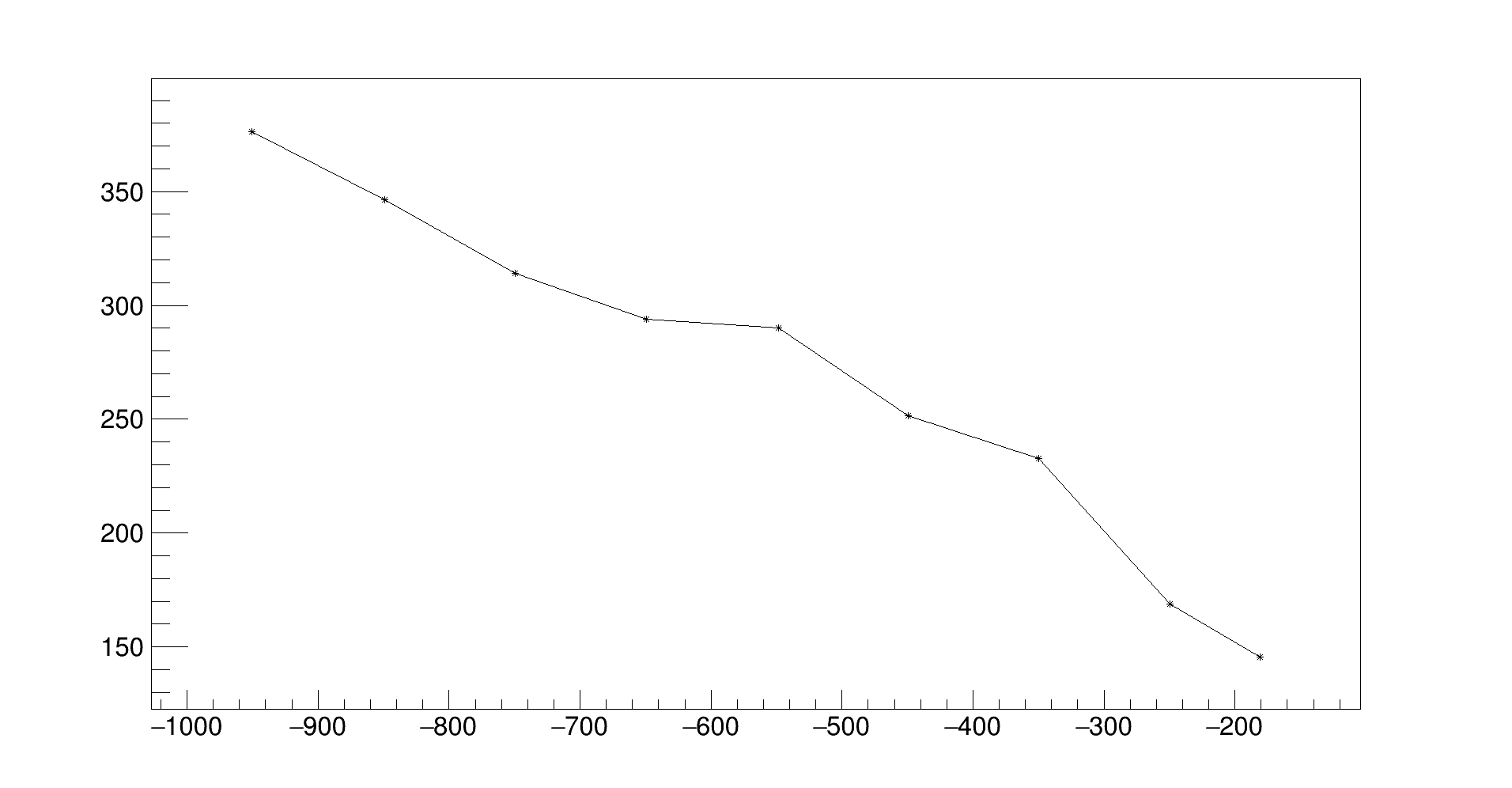

I ran a simulation measuring the deposited energy by protons and neutrons in a ball of water (r=15cm).
The ball is placed at the center (0,0,0) of an empty (G4_Galactic) mother volume.
The beam is pointlike and monoenergetic (Ebeam = 1 GeV) along the z-axis with a random initial position z between 16cm (just before the surface) to 1 meter from the center. I look at the deposited energy Edep as a function of the distance from the center of the ball.
Of course, I expect no dependency on Edep with z. Protons and neutrons are stable enough to reach the target without decaying and this is what I observe with protons, however with neutrons, I obtain a strong unexpected dependency.
(y-axis is Edep im MeV, x-axis z in mm)
Here is all the code where the result should be easy to reproduce:
[GitHub - sylvathle/NeutronChangingDose: Test of energy deposition in a ball of water by neutrons, varying distance of beam](https://Code source on Github)
What am I doing wrong?

Really interesting and unexpected that you don’t get the same result with the same code. The deposited energy you get is around 132 MeV, consistent with the last point on my graph.
I ran this with Geant4 11.1.1, which version are you using?
This also gave me the idea to try on an old pc that has version 11.0.1 installed and this dependency disappeared, this is really odd.

I am using 11.0.0. I wonder what 11.1.1 would have introduced that would cause this discrepancy? It is also interesting that you have the correct energy value (~130MeV) at your closest distance, and you have higher energy depositions at further away? The only thing I could think of, is if G4Galactic is treated differently and your neutron is somehow being moderated and then depositing more energy in your sphere
