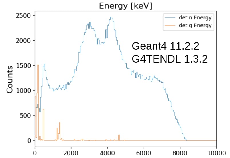

We tried the G4TENDL version 1.3.2 with Geant4 version 11.2.2, and the neutron library seems responsible for the differences. Below is a plot of the result.
The neutron spectrum is now pretty much the same as in 10.7.4, except for small differences in the lower end. The gamma peak appears to be still missing, though!
It seems like you were right about the cause.
I guess we have to find out, which neutron library is the one to be used.
