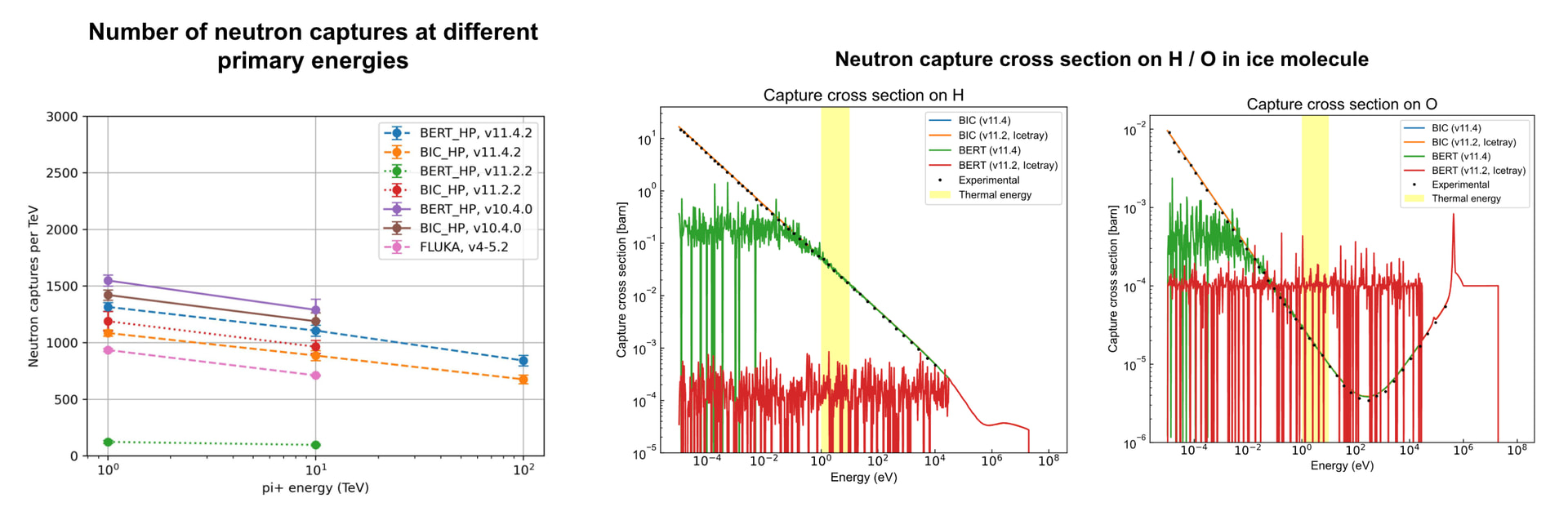

I am comparing simulations performed with Geant4 v10.4.0, v11.2.2, and v11.4.1. In my study, I inject a 1 TeV π⁺ into a 100m ice cube and record the number of neutron captures over time.
I observed the following behaviours for the physics lists:
  • QGSP_BERT_HP:
    • The number of neutron captures is 10 times smaller in v11.2.2 than in other versions. More than 80% of neutron tracks terminate by “Transportation” at the detector boundary, which doesn’t occur for other physics lists and versions.
    • The number of captures increases in v11.4.2, but the capture lifetime (469 μs) is significantly longer than the expected 220 μs.
    • The neutron capture cross section differs between versions.
  • QGSP_BIC_HP:
    • The number of neutron captures decreases by about 25% across these versions.
    • The lifetimes are consistent with 220 us.
I read this forum discussion from two years ago, and I was wondering whether there are further developments to the NeutronHP package that may explain these behaviours (the large reduction in captures in v11.2.2, the longer capture lifetime in v11.4.1, and a slight decrease in capture using QGSP_BIC_HP).
