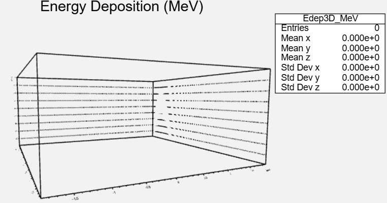

I am currently working on scoring energy deposition in 3D histograms. When I use G4RunManager in non-multithreading (sequential) mode, the results appear correctly. However, after switching to multi-threading mode,G4MTRunManager, the scoring results always show zero.
Could you please advise what might be causing this issue, or suggest any points I should check when implementing scorers in MT mode?
Thanks!
Masai
//this is my runaction.cc
void RunAction::BeginOfRunAction(const G4Run* run)
G4AccumulableManager* accumMgr = G4AccumulableManager::Instance();
accumMgr->Reset();
auto analysisManager = G4AnalysisManager::Instance();
analysisManager->SetNtupleMerging(true);
analysisManager->Reset();
// if (IsMaster()) {
analysisManager->OpenFile("SWG_Target_Edep3D");
// 0
analysisManager->CreateH3("Edep3D_MeV", "Energy Deposition (MeV)",
fBinX, -fMeshX, fMeshX,
fBinY, -fMeshY, fMeshY,
fBinZ, -fMeshZ * 2, 0.0,
"mm", "mm", "mm");
//1
analysisManager->CreateH3("Edep3D_joule", "Energy Deposition (joule)",
"mm", "mm", "mm");
void RunAction::EndOfRunAction(const G4Run* run)
G4AccumulableManager::Instance()->Merge();
analysisManager->Write();
analysisManager->CloseFile(false);
void SteppingAction::UserSteppingAction(const G4Step* step)
G4double nonIonEdep = step->GetNonIonizingEnergyDeposit();
G4double totalEdep = step->GetTotalEnergyDeposit();
G4StepPoint* preStep = step->GetPreStepPoint();
G4ThreeVector pos = preStep->GetPosition();
if (totalEdep <= 0.) return;
G4VPhysicalVolume* volume =
step->GetPreStepPoint()->GetTouchableHandle()->GetVolume();
G4String volumeName = volume->GetName();
if (volumeName == "Target") {
auto analysis = G4AnalysisManager::Instance();
G4int Edep3D_MeV_id = analysis->GetH3Id("Edep3D_MeV");
//G4cout
// << "User messager: [Thread " << G4Threading::G4GetThreadId()
// << "] Filling at " << pos
// << " edep(MeV)=" << totalEdep / MeV
// << G4endl;
analysis->FillH3(0, pos.x(), pos.y(), pos.z(), totalEdep / joule);
analysis->FillH3(Edep3D_MeV_id, pos.x(), pos.y(), pos.z(), totalEdep / MeV);
