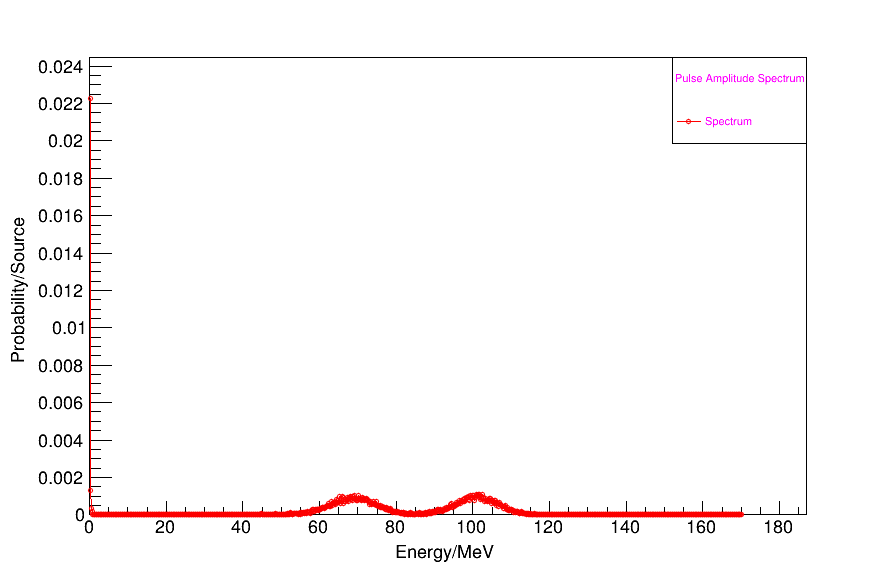

@atolosad, @maire1 ,
I know how to produce the fission fragment in main function long time ago, like this:
G4ParticleHPManager::GetInstance()->SetProduceFissionFragments( true );
or
G4ParticleHPManager::GetInstance()->SetUseWendtFissionModel(true);
and when using the codes:
if(volume_pre==fPostVolume)
    fEventAction->AddEnergy(step->GetTotalEnergyDeposit());
i can obtain the pulse amplitude spectrum:
but now, i want the spectrum only by fission fragment, as the codes top,
the fission reactions take place, but only neutron and gamma are produced in the fission reactions.
this is wired, why?

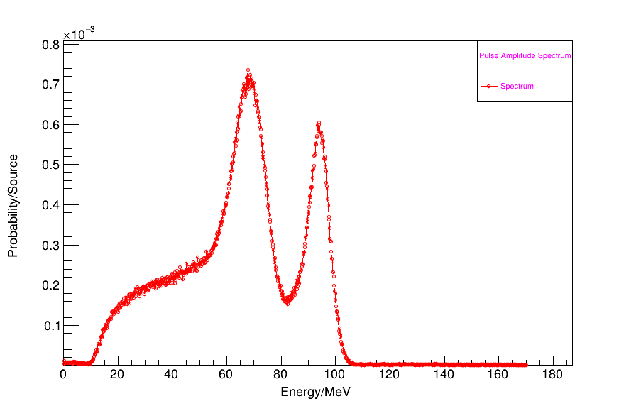

@maire1 , fission fragments are always explicitly generated in my application, here is another pulse amplitude spectrum include fission fragments calculated by Geant4:
@mkelsey, the two peaks in the figure separately associate the lighter fission fragments and the heavier fission fragments,
