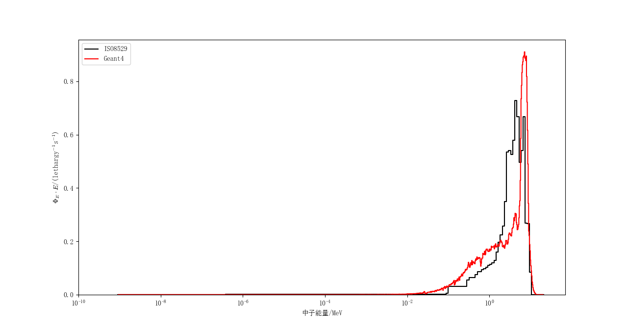

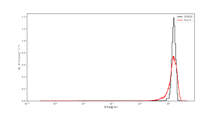

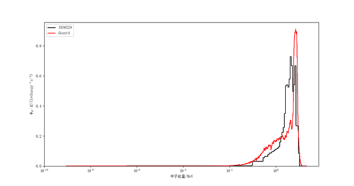

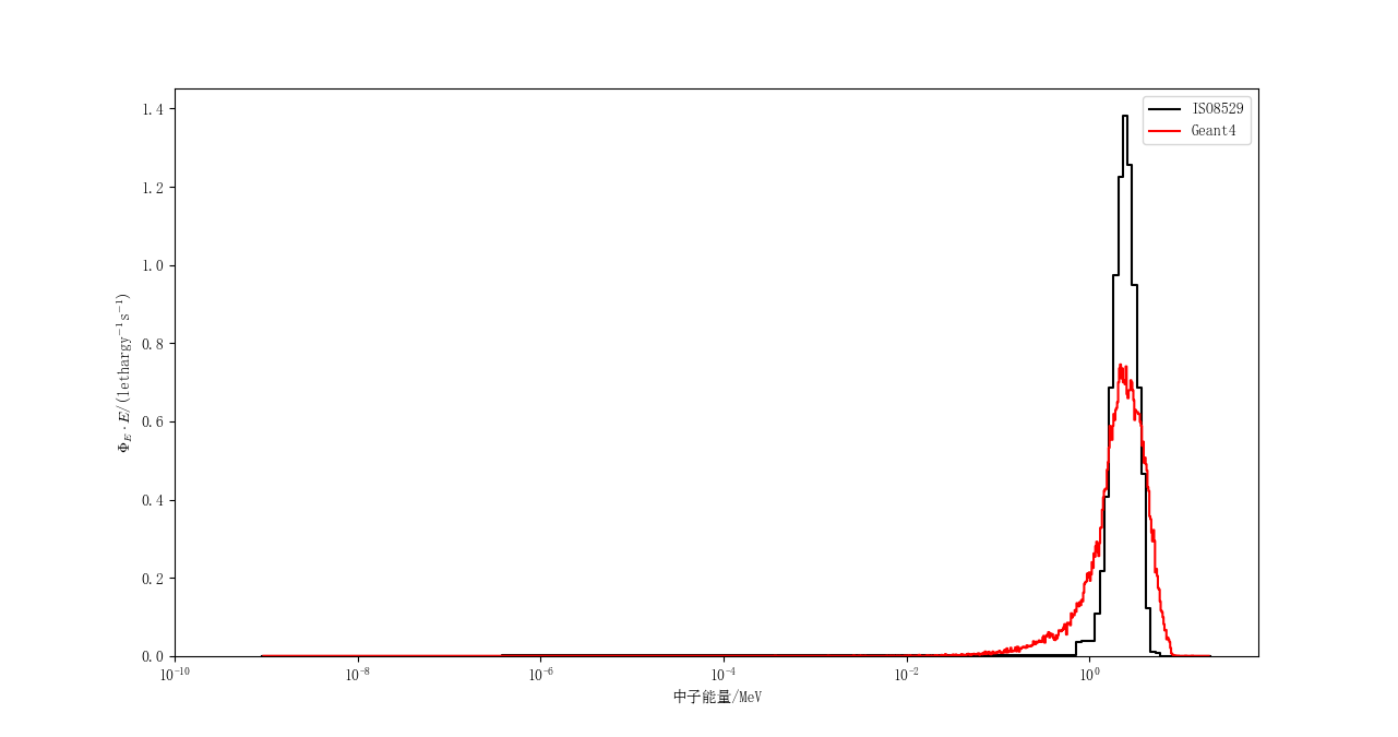

The spectrum calculated by Geant4 is not consistent with the one from ISO 8529-1, the difference is shown in the figure below:
Am241_Be neutron source:
Am241_B neutron source:
