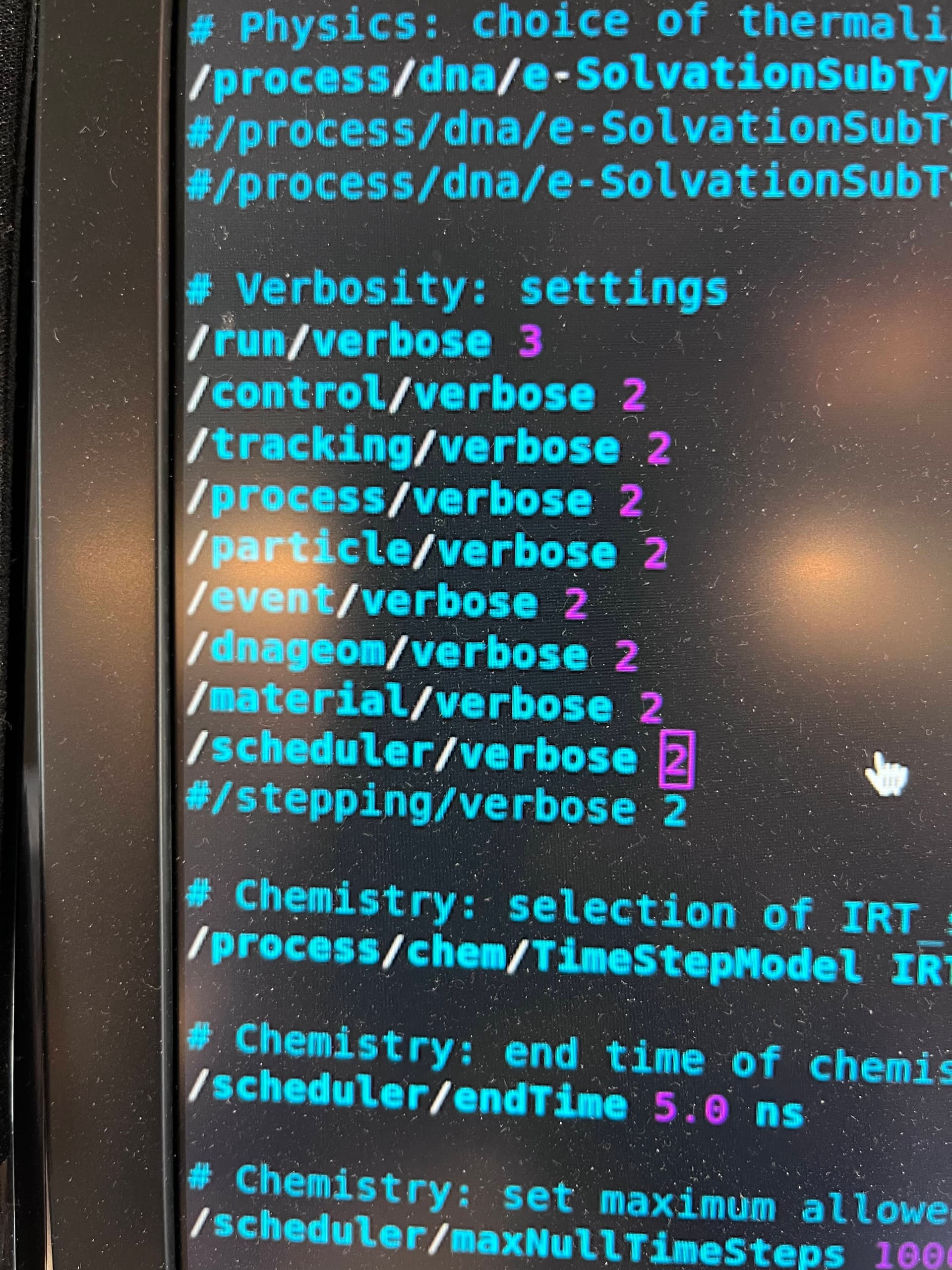

I tried “-t 1” but it didn’t seem to help.
I then set every verbosity setting I could find to 2:
But while it’s showing more info, it’s still not helpful quite yet:

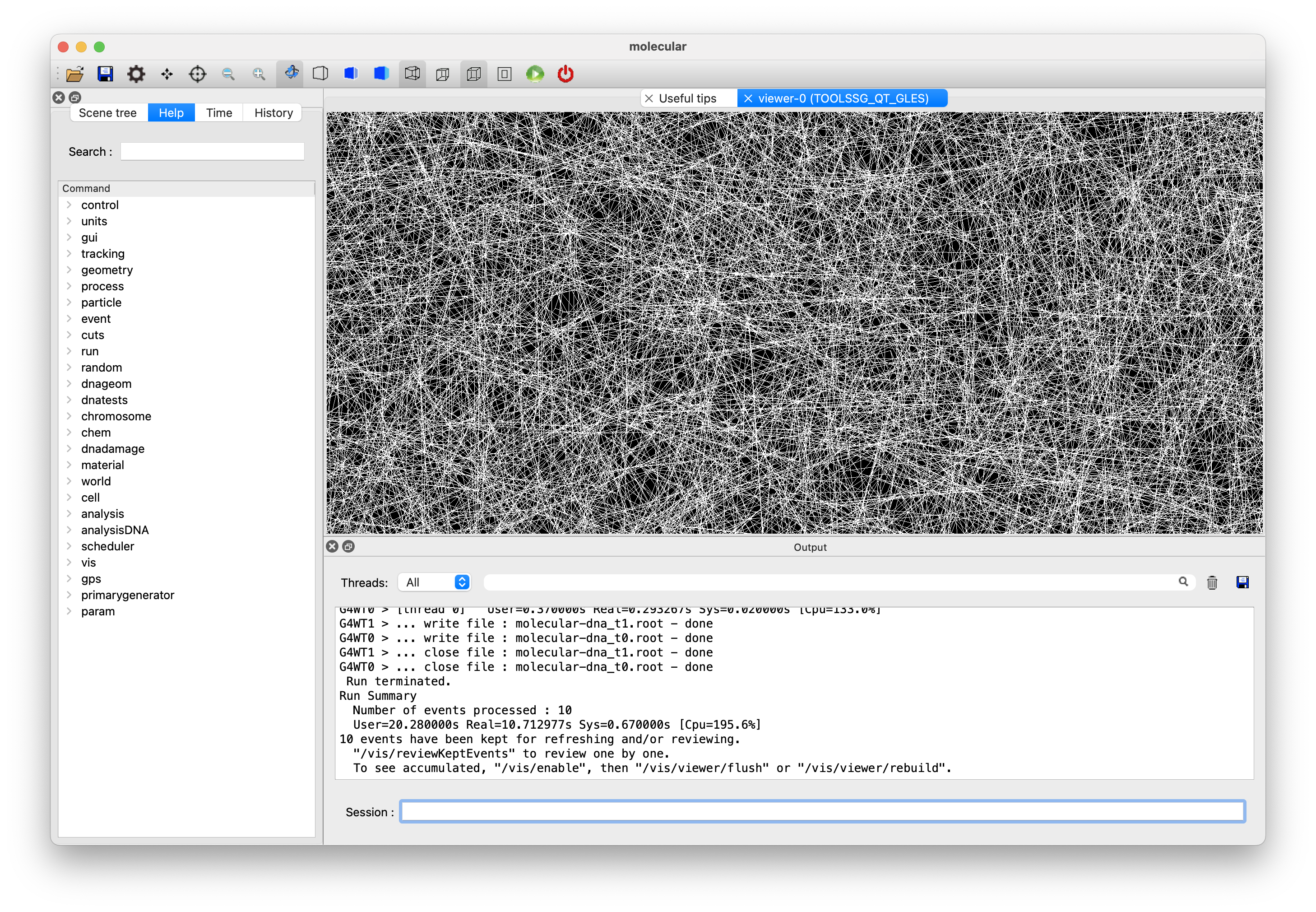

I eventually got around to studying the README file and tried their first suggestion:
./molecular -m cylinders.mac -t 2 -p 2
It ran quite quickly, producing two .root files (I have not inspected them).
Because I like running with the Qt GUI, I tried
./molecular -t 2 -p 2
(though I think ./molecular on its own will do, since -t 2 -p 2 is the default - see molecular.cc.)
and then
/control/execute cylinders.mac
Again, it ran OK (took about 2 minutes), memory never rising above 1 GB, and eventually produced an image that looks like a spider’s web - see below. I think most of the memory and time would have been consumed in building the graphical database.
