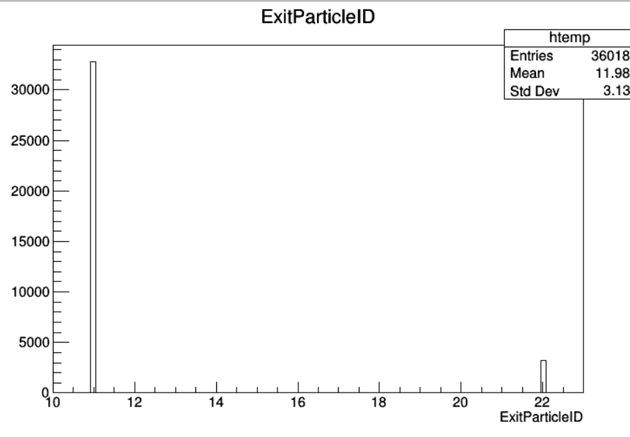

…but now I think to have a Geant 4 problem…
in the steppingaction I’ve
G4String getparticles;
G4String ThisVolume;
G4String NextVolume;
if (fPrimaryPositronElectronExitFlag){
	ThisVolume= "Target2";
	NextVolume= "World";
	getparticles = "NextVol && ThisVol->GetName()==ThisVolume && NextVol->GetName()==NextVolume && step->GetTrack()->GetParentID()==00 && (step->GetTrack()->GetDynamicParticle()->GetPDGcode()==11 || step->GetTrack()->GetDynamicParticle()->GetPDGcode()==-11)";
			if(getparticles) {
			 		    int pdg = step->GetTrack()->GetParticleDefinition()->GetPDGEncoding();
			 			analysisManager->FillNtupleDColumn(1,0, pdg);
			 			double kinEnergy = step->GetTrack()->GetDynamicParticle()->GetKineticEnergy();
			 			analysisManager->FillNtupleDColumn(1,1, kinEnergy);
then I should selecto only e+/- primary particles…instead in the root file I see phtons…
then I don’t understand the reason because of it selectes secondary photons…

PS. I also tried to write
getparticles = "NextVol && ThisVol->GetName()==ThisVolume && NextVol->GetName()==NextVolume && step->GetTrack()->GetParentID()==00 && (step->GetTrack()->GetDynamicParticle()->GetPDGcode()==13 || step->GetTrack()->GetDynamicParticle()->GetPDGcode()==-13)";
but I still get electrons and photons…then it looks like that the selection doesn’t work…
Please get some basic texts and instruction in writing C++. This is not Python.
You don’t create strings and expect them to be “interpreted” at run time. You write actual code.
Sorry @mkelsey …I don’t understand what you mean…here C++ Strings there is an example of string and it’s made like I did…so what is strong in my code?
G4String var1 = "This is a text string";    // this is just a bunch of characters
G4String var2 = "E>0 && x<5*cm";        // this is *also* just a bunch of characters
 if (var2) {     // This tests whether the var2 variable is not equal to zero
That if statement does not evaluate the string as math. The string is just a bunch of characters (bytes in memory). All it is doing is testing that the variable var2 is located at a memory location which is not 0x00000000.
If you want to evaluate a condition, then you put the condition into the if statement:
if (E>0 && x < 5*cm) {     // This tests the _variables_ E and x

No. Geant4 is a C++ application. You write C++ code, using the features and limitations of the language. You already wrote the conditional expression, just stop putting it in quotes, and put into the if expression directly. Please learn the basics of C++, so that you will have a clear understanding of how the software is written.
