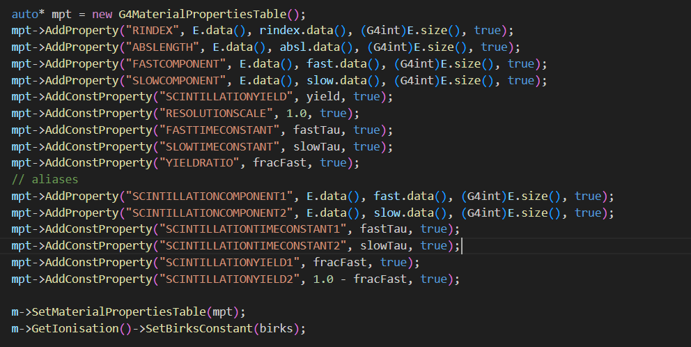

Hello All ,
I have this example, i try to use EJ212 material as detector crystal (Scintillation detector). The problem is the optical photons are not generated however, I check many time the optical process is turn on. I do not understand where the issues.
ActionInitialization.cc (1.2 KB)
PrimaryGeneratorAction.cc (1.6 KB)
PhysicsList.cc (5.8 KB)
DetectorConstruction.cc (11.8 KB)
