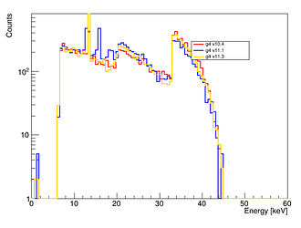

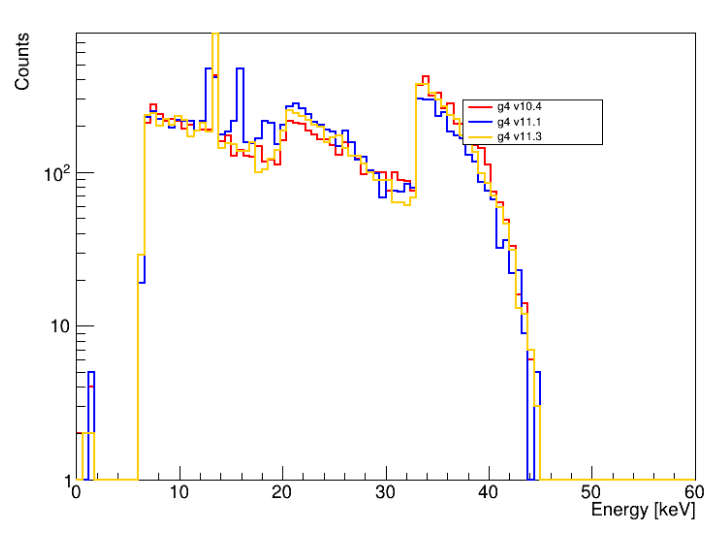

While comparing results obtained with Geant4 v11.1.1 and v11.3.0, I observed that the differences between the PhotonEvaporation datasets (PhotonEvaporation-5.7 for Geant4 11.1.1 and PhotonEvaporation-6.1.2 for Geant4 11.3.0) for Ac-228 lead to the following changes in the resulting spectrum of Ra 228:
Neither dataset includes the gamma intensities (Iγ) for the transitions at Eγ ≈ 12.75 keV (12.88 keV in the Geant4 datasets) and Eγ ≈ 26.4 keV in agreement with ENSDF. In particular, for the 26.4 keV transition, I could not find any available Iγ value in ENSDF.
Additionally, I observed that in other cases Geant4 provides values (e.g., for internal conversion coefficients) even when corresponding data is not explicitly available in ENSDF.
