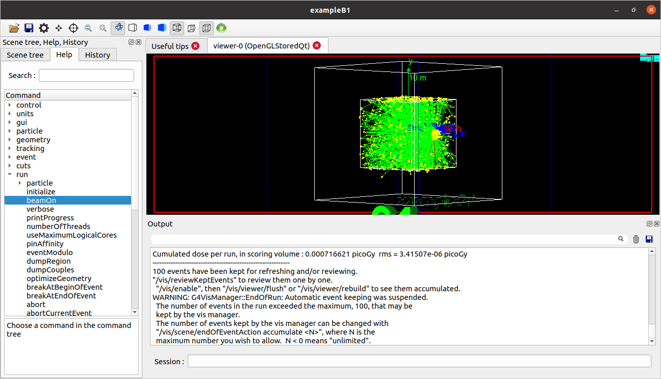

I am working with a 18.5 MeV neutron source with a concrete bunker as shield.
I am facing a problem,
Without the HP model, FTFT_BERT and QGSP_BERT, QBBC etc are working fine.
But when I take FTFT_BERT_HP, QGSP_BER_HP, the High Precision models, the bunker can’t shield all the beams. Figure below.
Should I ignore the transmitted neutrons? And why HP models are unable to shield these? I fear there is some problem here. Please suggest which physics list I should use here?

The bunker is a 101010 cubic meter hollow box where inner wall thickness is 2.44 m all around. In the center, a neutron particle gun is set and bombarding along z direction. I am using varoius concrete mixtures , you can try G4_concrete.
The run3.mac file is here.Processing: run3.mac…

I also have tried shielding, but this also results the same.
