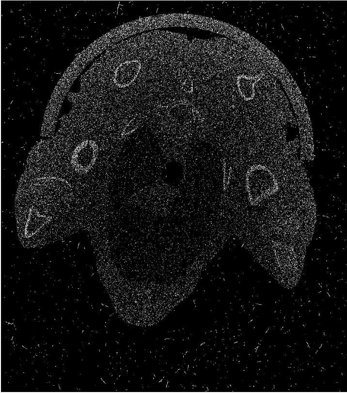

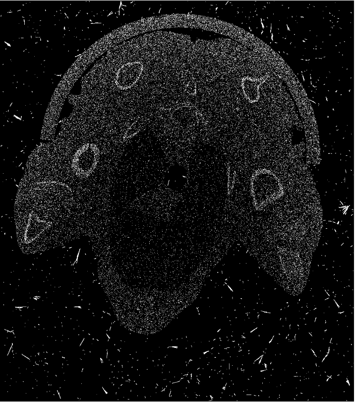

Long story short I am trying to measure dosimetry delivered by x-ray imaging, to do this I constructed an object using G4PVParameterisation and attached a dosimetry primitive scorer to it. My issue is that the results from this detector occasionally produce nans or much larger values than what I would measure in a scoring mesh.
Following are examples of this where the left image is from a macro based scoring mesh and right is from my sensitive detector.
In the sensitive detector image there are a bunch of brighter streaks appear that are not in the scoring mesh image. Occasionally these artefacts also include nans, I assume from some kind of divide by zero error. It predominantly occurs in low density materials such as G4_AIR and only very rarely appears in a material like G4_WATER. It seems to be from electrons being created as secondary particles but I don’t know what part of my code could be causing it given the how it varies depending on the material.

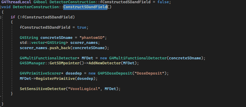

  • Following is the code I use for my ConstructSDandField

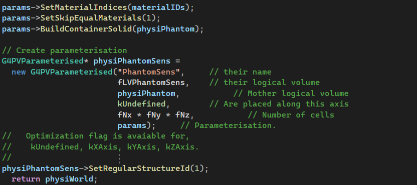

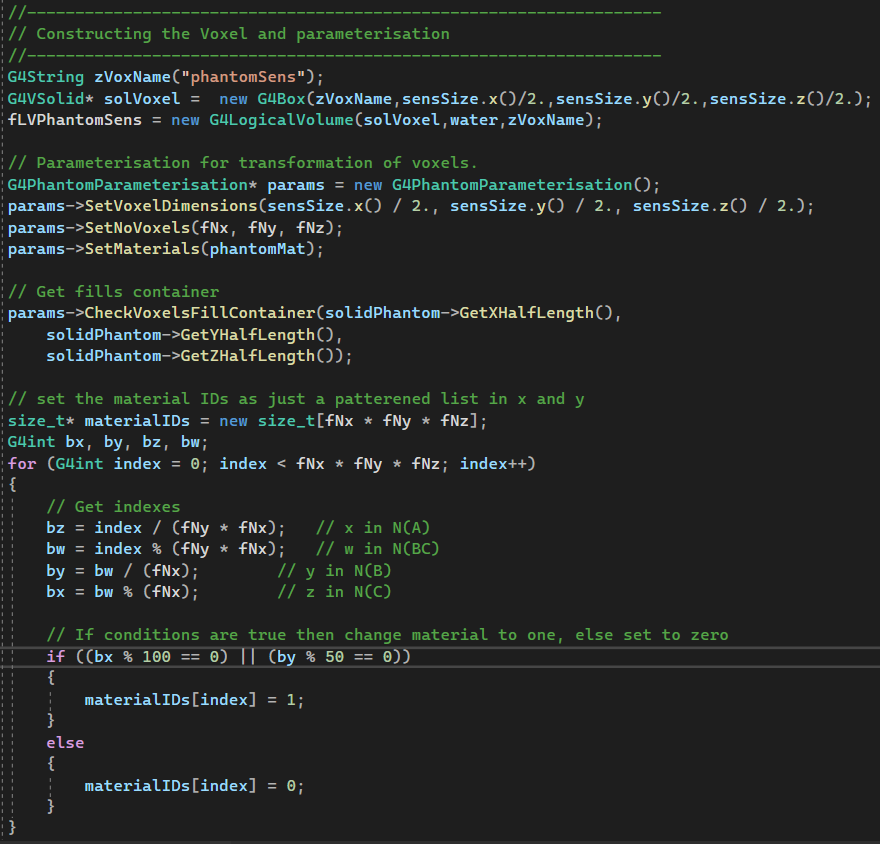

I want to do an update but I can no longer edit the question etc so I am just going to reply instead.

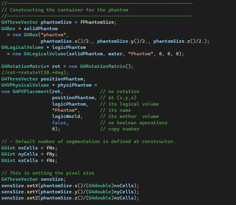

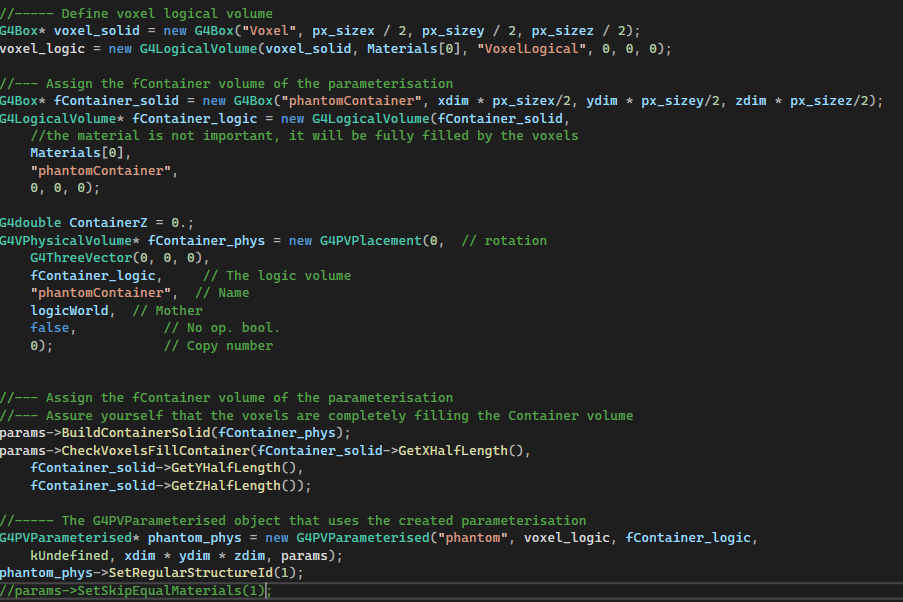

I restarted using the RE02 example instead and slowly modified it by adding features of my old code back into it. I found at least one part causing my nans is where I run SetRegularStructureID(1). My understanding was that this can just be applied to simple geoemtries to use a more efficient form of navigation through the volume, why would it be causing nans to be made?
Following are pictures of the simplified code showing how I am using the G4Parameterisation
Running with SetRegularStructureID creates nans, running without does not. Unfortunately the manual does not really provide a description for the command but it allows greater speed which I definitely need in my code, what’s more I don’t see a reason for it not to be working.

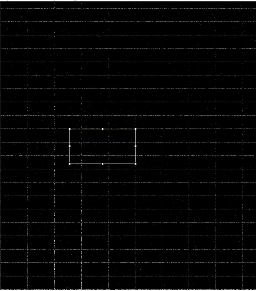

The phantom I’m looks like the following in each slice
