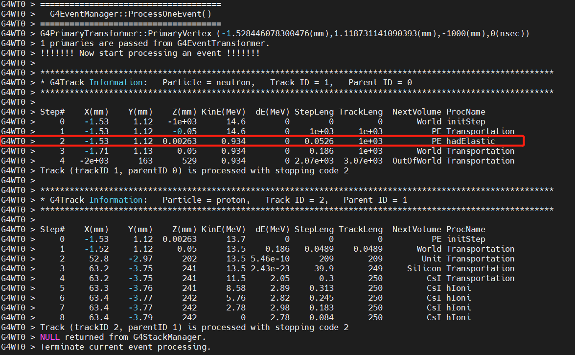

I’m doing a simulation that fast neutrons (10-20 MeV) are impinging on a polythene (PE) sample. I’m interested in the elastic scattering that happed between the incident neutrons and the hydrogen in the PE sample. I want to retrieve this hadElastic process in the TrackingAction but I failed.
I think the elastic scattering process did happen since I saw it when I set the tracking verbose as 1. You may see it in the below picture.
When I try to access and print the physics process name in the PE sample with following codes in TrackingAction:

It only printed “neutronInelastic” process, but the “hadElastic” process was not printed at all. I do not understand this.
