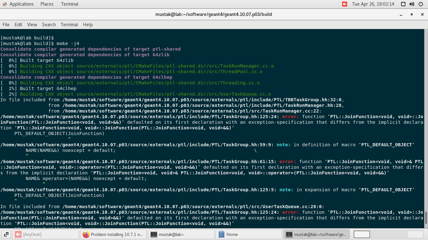

I am facing similar problems in trying to install 10.7.p03 in centos 7. I tried the solution mentioned in this thread but it didn’t work. I have attached the screenshot of the error message. I am also attaching the cmake error log and the cmake output file. Please help!
CMakeOutput.txt (53.9 KB)
CMakeError.txt (1.7 KB)
From the CMakeOutput.txt file, it’s clearly picking up the system compiler:
gcc version 4.8.5 20150623 (Red Hat 4.8.5-44) (GCC)
Did you run CMake then make in a scl session, i.e.:
$ scl enable devtoolset-7 bash
[scl]$ cmake <args>
[scl]$ make
? NB: the prompt after the first line won’t literally be “[scl]$” , I just used that to illustrate that a new shell should have been started.
