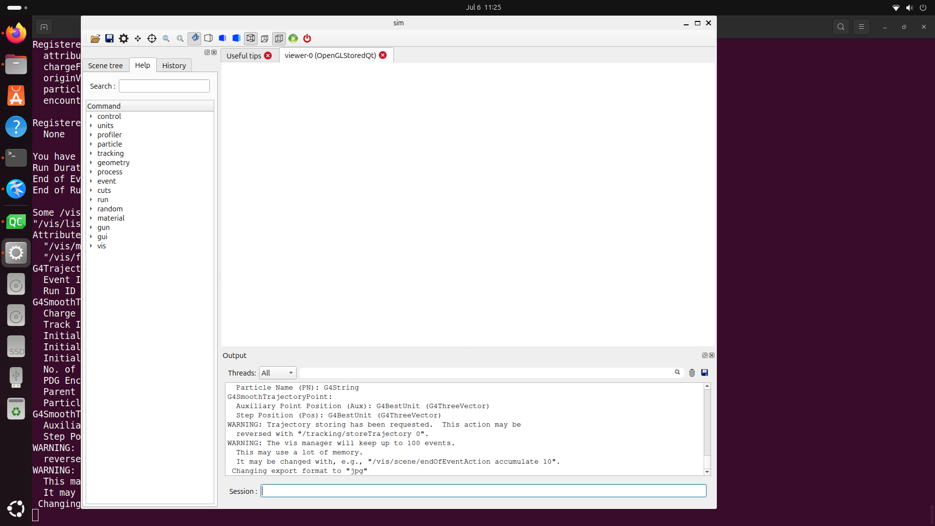

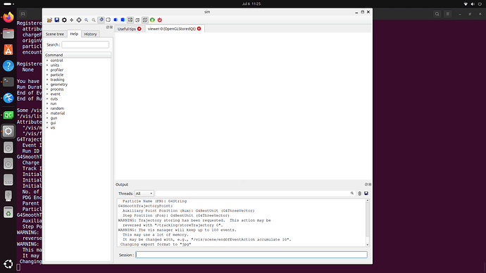

Problem with QT on ubuntu
I am working on a very basic Geant4 project with a proton particle gun.
The project is kept here:
The project is compiling fine without any errors.

While I do not see any error, the OpenGL box is shown in the following fashion:
I cannot see the detector setup or the particle gun tracks.
I need to see them in order to understand the simulation process
Please help me here.

Hi Arka
Issues like this in the past have often been due to the graphics card driver. Please make sure yours is up to date. Google the Intel site for a driver for your graphics card and system.
Get back to us if this does not fix it.
HI. Your problem is likely the same as in this post Problem with visual window . If your system is running the Wayland windowing system (the default on a lot of modern Linux OS), your geometry window will be transparent due to an incompatibility between Wayland, X and Qt. The simplest solution is to login to a session which uses X11 (e.g., Plasma or Gnome on Fedora allow you to switch from X to Wayland at the login prompt). If that is not possible, you can recompile Geant4 with X11 ON and Qt OFF. When you run an application, you will then get an X11 geometry window, but the terminal display will be in a simple X terminal and there will be no GUI.
