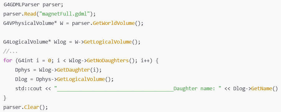

I have strange behavior in the program when constructing detector components from a .gdml file.
In the first function, I read the first file, and everything works fine. (This part of the code seems significant for describing the issue.)
This function outputs the names of the daughter volumes from the magnetFull.gdml file.
Then, I call another function, which contains the same lines, but opens secondMagnetYoke.gdml file.
As a result of running this function, I get the message that the secondMagnetYoke.gdml file was read (so far, everything is correct). However, the list of daughter volumes is the same as the one from the previous file.
Meanwhile, if I run only the second function, I get data from the secondMagnetYoke.gdml file.
Can you suggest what might be the problem and how it can be fixed?
I’ve tried to use different names of parser and other objects but it doesn’t case (obviousely)
P.S. Unfortunately, using a single file for both magnets in my case is very inconvenient.
I was experiencing a similar issue, where I was reading in two GDML files and it would twice take the volume from whichever file was loaded first, and seemingly ignore the second file’s volumes. It turned out that there was a name, “Step_1”, which was reused for the solidref of the object in each file. Changing all occurrences in the files to, say, “Step_1_1” and “Step_1_2” fixed the issue for me. Hope this helps!
