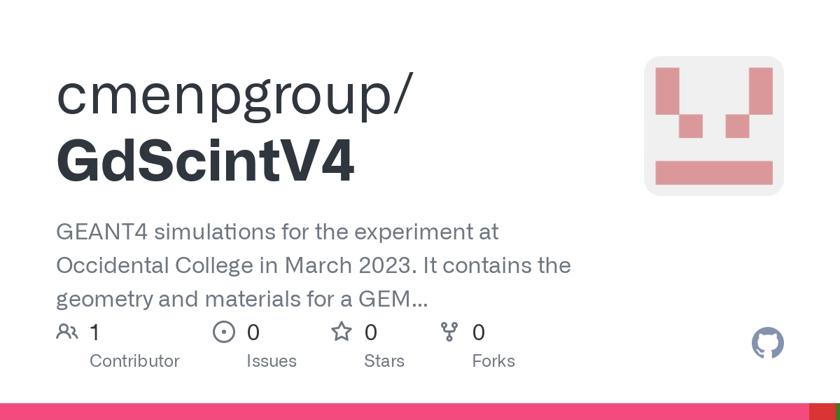

If you could look at the code, that would be great. Here is the GitHub repo:

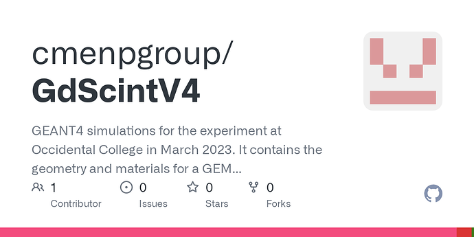

I am continuing to troubleshoot the issue. I get the following error message after a track is processed:
“NULL returned from G4StackManager. Terminate current event processing.”
I ran the code without a logical volume assigned to the sensitive detector and the issue persisted. The sensitive detector pointer (myGdScintSD) is also initialized as NULL.
Additionally, there is an issue at line 59 of EventAction.cc (see file in my GitHub in previous reply), the CollectionID is NULL.
Help is greatly appreciated.
