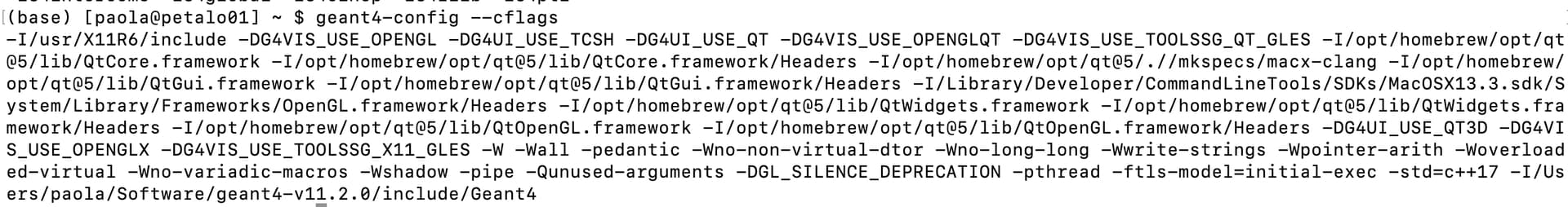

This is the output:
-I/usr/X11R6/include -DG4VIS_USE_OPENGL -DG4UI_USE_TCSH -DG4UI_USE_QT -DG4VIS_USE_OPENGLQT -DG4VIS_USE_TOOLSSG_QT_GLES -I/opt/homebrew/opt/qt@5/lib/QtCore.framework -I/opt/homebrew/opt/qt@5/lib/QtCore.framework/Headers -I/opt/homebrew/opt/qt@5/.//mkspecs/macx-clang -I/opt/homebrew/opt/qt@5/lib/QtGui.framework -I/opt/homebrew/opt/qt@5/lib/QtGui.framework/Headers -I/Library/Developer/CommandLineTools/SDKs/MacOSX13.3.sdk/System/Library/Frameworks/OpenGL.framework/Headers -I/opt/homebrew/opt/qt@5/lib/QtWidgets.framework -I/opt/homebrew/opt/qt@5/lib/QtWidgets.framework/Headers -I/opt/homebrew/opt/qt@5/lib/QtOpenGL.framework -I/opt/homebrew/opt/qt@5/lib/QtOpenGL.framework/Headers -F/opt/homebrew/Cellar/qt@5/5.15.8_3/lib -DG4UI_USE_QT3D -DG4VIS_USE_OPENGLX -DG4VIS_USE_TOOLSSG_X11_GLES -W -Wall -pedantic -Wno-non-virtual-dtor -Wno-long-long -Wwrite-strings -Wpointer-arith -Woverloaded-virtual -Wno-variadic-macros -Wshadow -pipe -Qunused-arguments -DGL_SILENCE_DEPRECATION -pthread -ftls-model=initial-exec -std=c++17 -I/Users/paola/Software/geant4-v11.2.1/include/Geant4

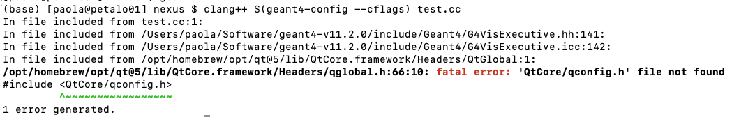

I did what you suggested and I still get the same error (output attached).
Apologies, your code does work (I was picking up the wrong G4 version).
O.k., if that’s working, then building your full code with v11.2.1 should also work as that basically exercises the problem. What output/error are you seeing in the build of your code - is it picking up the correct Geant4 version, or has SCons cached something?
