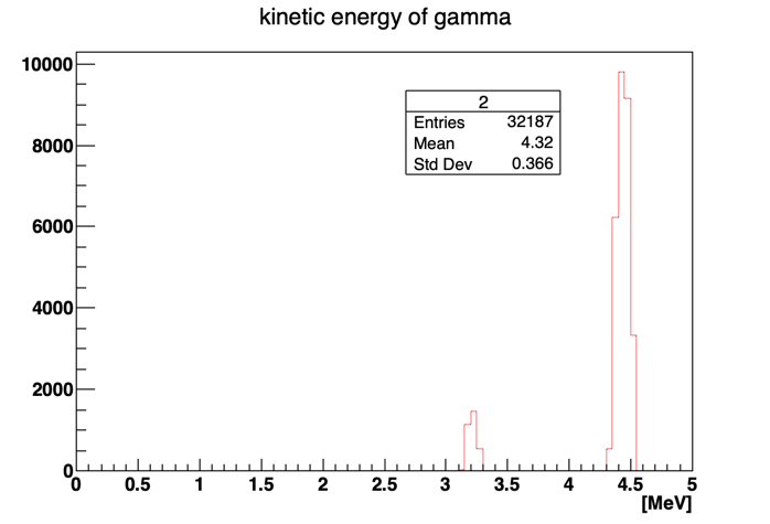

Here, a run of example Hadr03.
we do not observe those splitted gamma
njeri.mac.txt (381 Bytes)
njeri.out.txt (2.9 KB)

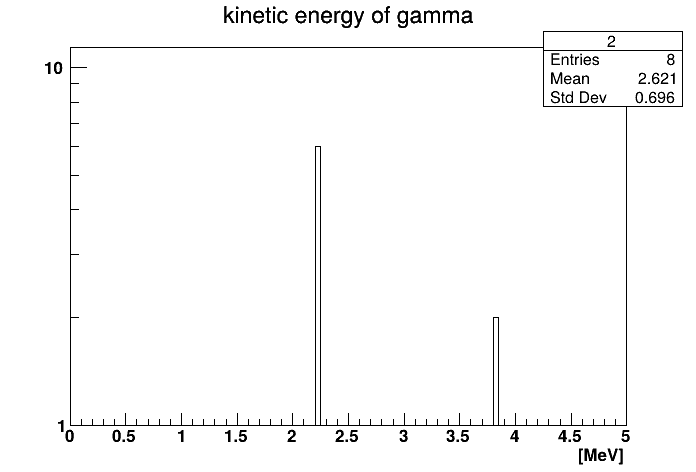

Hi @maire1
Thanks for looking into this and testing it with the Hadr03 example.
In my simulation, I am using the standard pre-packaged QGSP_BIC_AllHP physics list, rather than a custom modular list. I noticed that the example registers multiple alternative physics lists, and with your sample macros, tried to see if the same pattern I observe in my simulation appears in the example with the exclusive use of QGSP_BIC_AllHP.
With the only changes I’ve made to the example’s main.cc being:
#include "QGSP_BIC_AllHP.hh"
// #include "PhysicsList.hh"
// in main()
G4VModularPhysicsList* phys = new QGSP_BIC_AllHP;
runManager->SetUserInitialization(phys);

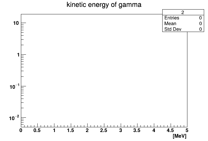

I run it with two scenarios:
  • Scenario 1: The environment variables calls commented out - Best replicates my simulation
  • Scenario 2: The environment variables as in the original example
comparison.out.txt (5.9 KB) - Gives the extracted data from the ‘.out’ file for both scenarios
And the gamma plots I get are as shown. Scenario2 results in a blank plot. From scenario1, the split of the 4.44 MeV gamma would contaminate the neutron capture peak when introducing a hydrogenous material
