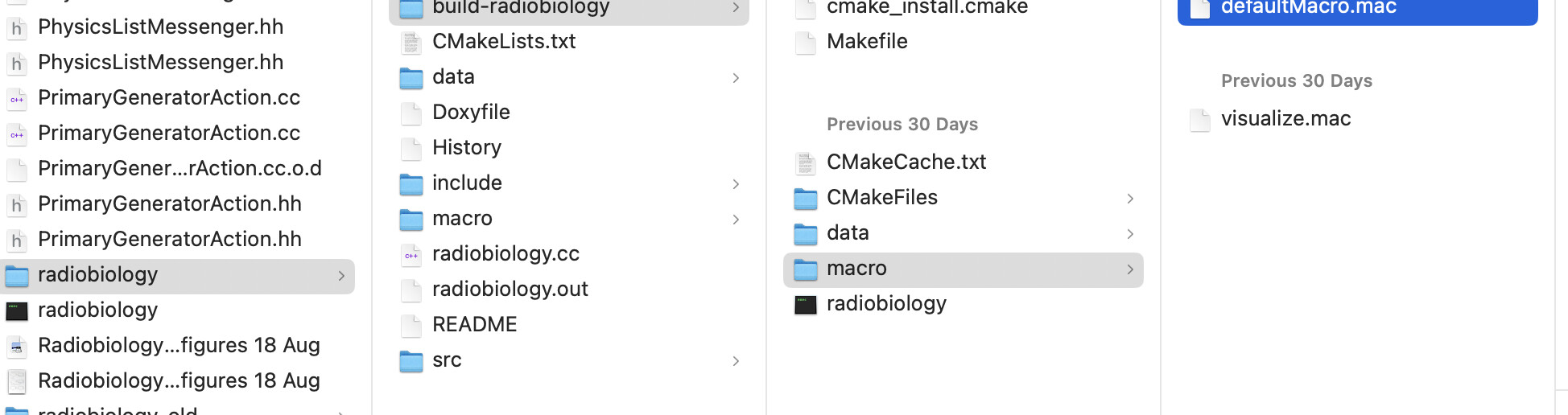

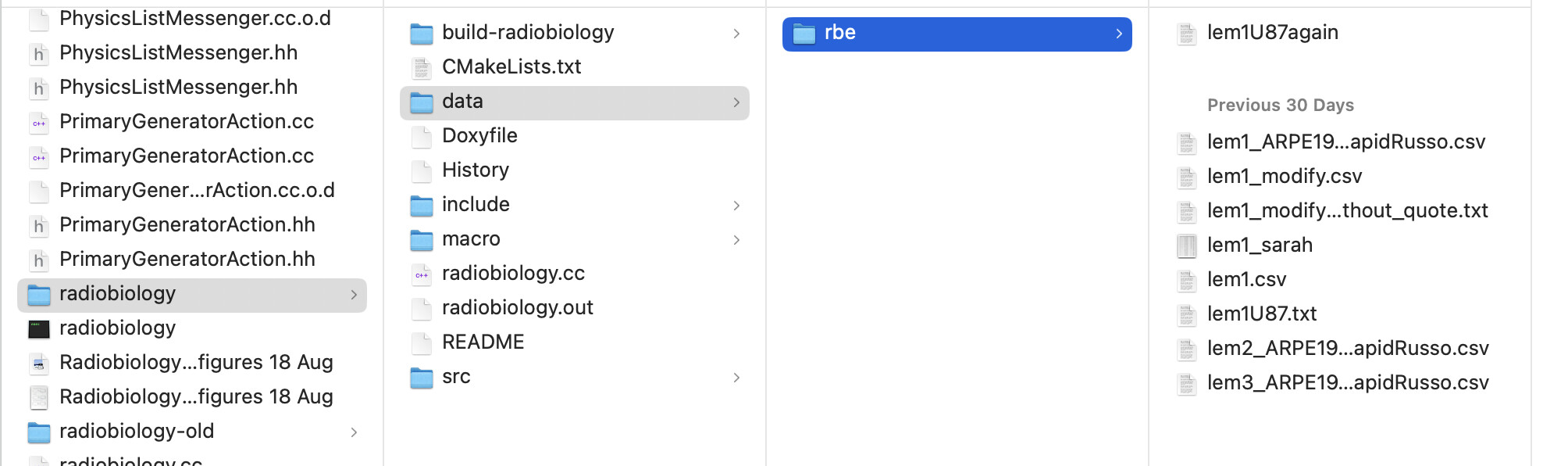

Again I do a new file with these steps in a plain text file. Then, do cmake for the source folder of radiobiology, then modify the macro file of build folder for the new file.
sarahabdelaziz@Sarahs-MacBook-Pro build-radiobiology % ls
CMakeCache.txt cmake_install.cmake radiobiology
CMakeFiles data
Makefile macro
sarahabdelaziz@Sarahs-MacBook-Pro build-radiobiology % cmake -DCMAKE_PREFIX_PATH=/opt/geant4/11.3.2 ..
– Could NOT find WrapVulkanHeaders (missing: Vulkan_INCLUDE_DIR)
– Configuring done (2.5s)
– Generating done (0.5s)
– Build files have been written to: /Users/sarahabdelaziz/geant4/radiobiology/build-radiobiology
sarahabdelaziz@Sarahs-MacBook-Pro build-radiobiology % make
[100%] Built target radiobiology
CMakeFiles data
Makefile macro

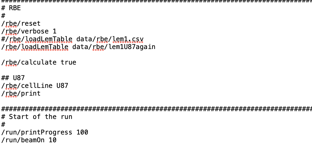

sarahabdelaziz@Sarahs-MacBook-Pro build-radiobiology % ./radiobiology macro/defaultMacro.mac
******* Parameters of the class LET *******
** Verbose level = 1 **********************
** Initialized = true *********************
** Saved = false **************************
** Calculation enabled = true *************
-------- EEEE ------- G4Exception-START -------- EEEE -------
*** G4Exception : WrongTable
issued by : RBE::LoadData
Cannot open LEM table input file: data/rbe/lem1U87again
*** Fatal Exception *** core dump ***
**** Track information is not available at this moment
**** Step information is not available at this moment
-------- EEEE -------- G4Exception-END --------- EEEE -------
*** G4Exception: Aborting execution ***
zsh: abort ./radiobiology macro/defaultMacro.mac

Hi Sarah,
I tested the file you shared on my mac and it works correctly for me. The CSV loads and the example runs without errors.
In the last output you sent, the issue was not the file format. The example could not find the RBE file at the path shown in the message. This usually means the file is not in the expected folder or the macro is using a different file name….
Hello!
What does it mean? I created it in the same path of source directory in data/rbe then do cmake and make. Then in the build directory, I called it to upload by its name.

Thank you for your help and your kindness. I again by using the terminal, not by do a new text file. I used command nano and do new file.csv by terminal and wrote in it the new values. This is good for reading the extension as csv, without adding any comma.
