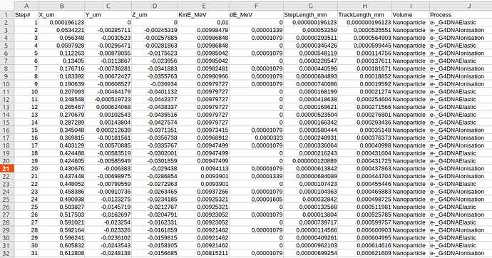

I have tried to code a very simple model : a sphere full of water with at its center a source of photo-electrons. I wish to record the ROS production. I think I succeed in retrieving all interactions, but I can’t manage to record the ROS. However, I checked some interactions have a deposited dose greater than 10-15 eV thus I think I should see some ROS. Here is an excerpt of the output obtained after simulation :
