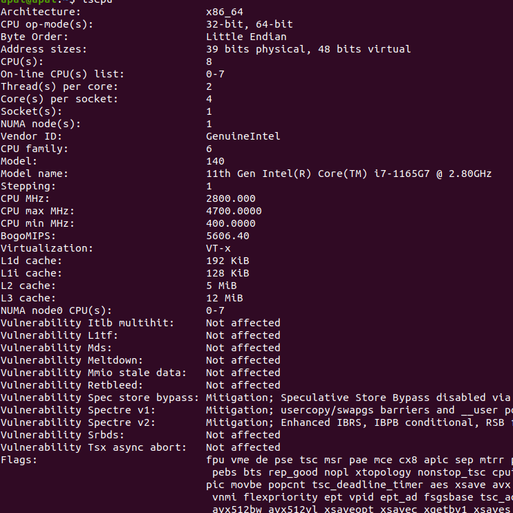

What OS/machine specs (CPU/RAM etc) are you running each application on, and how many threads are being used on each? What batch system (e.g. Slurm etc are you using)? 16hr vs 5min is a huge difference, so there’s either something in the code, or these are vastly different systems in capability.
Both machines has similar specs.
The one which taking 5 min with geant4 10 versions has the spec below:
And the other one which have geant4 version 11.1also has same spec .
Both were installed keeping multithread off . And I am not using any batch to generate the event.
