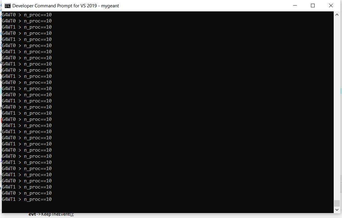

I tried to print
G4cout << "n_proc==" <<n_proc<< G4endl;
both with and without the filter
if(step->GetPostStepPoint()->GetProcessDefinedStep()->GetProcessName() == "Scintillation"){
and it always writes
