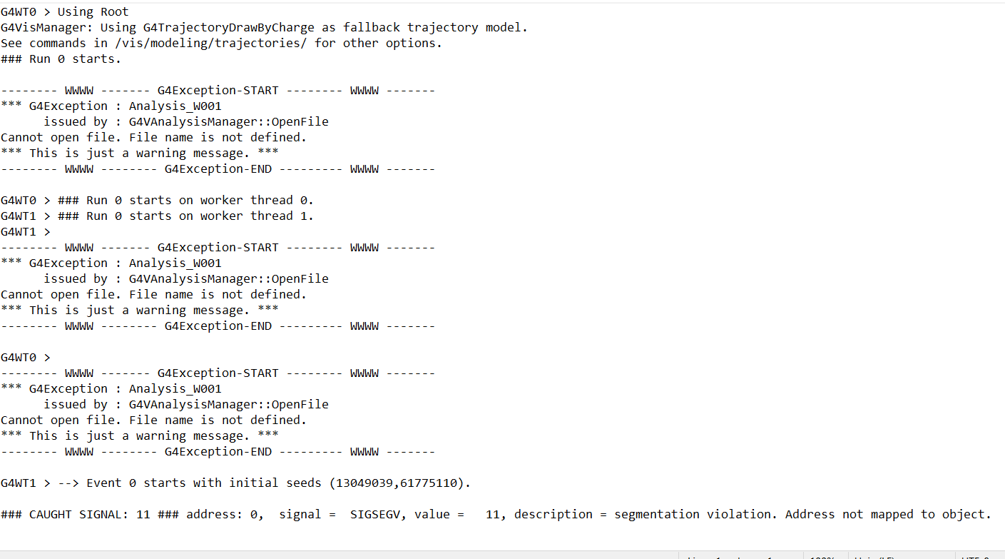

I don’t get errors during building and compilation, but when I run
  1. It doesn’t create the ROOT file
  2. I get this error and the simulation doesn’t continue

well, the error message in this case is quite specific, and luckily there is marvellous documentation for geant4 :slight_smile:
https://geant4-userdoc.web.cern.ch/UsersGuides/ForApplicationDeveloper/html/Analysis/managers.html#files-handling

in the documentation it uses
auto analysisManager = G4AnalysisManager::Instance();
that doesn’t work in my case…
anyway, I also tried to specify the .root extension
analysisManager->SetFileName("B1.root");
but I get the same error

try building your code in a fresh directory (that is a nice feature of using cmake and a build directory), and check that your environment variables are not containing references to the wrong version.
did you set the filename, e.g. as in example B5?
not sure what error you mean, if it is related to the ManagerInstance:
https://github.com/Geant4/geant4/search?q=ManagerInstance
no.
Finally I can run on G4 11!
