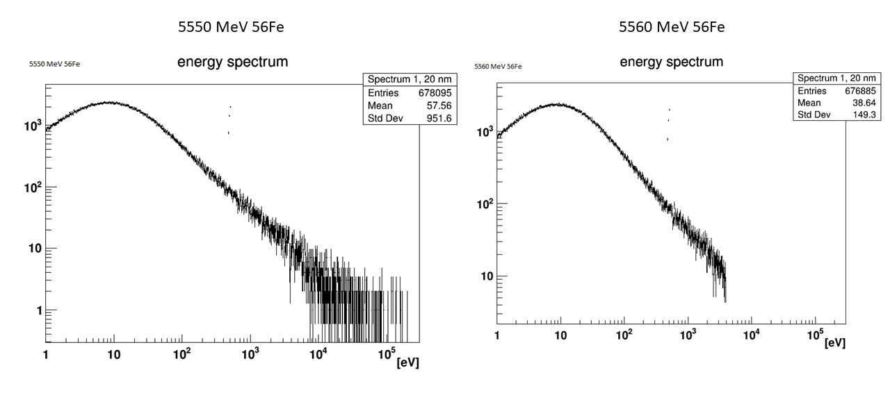

When increasing the kinetic energy of the primary I also expect an increasing maximum energy of the secondary electrons. Everything seems to be fine up to an energy of approximately 100 MeV/u (5550 MeV for 56Fe) where I expect a maximum secondary electron energy of about 200 keV. However, when I switch to slightly higher ion energies and add just a few MeV (5560 MeV), the maximum secondary electron energy drops by two orders of magnitude down to only a few keV. It seems like the energy spectrum is just cut off at a certain point. The rest of the spectrum seems fine.
I simulate a water box of 200x200x200 micrometer^3 and in its center I create a beam of ions. I follow the primaries along a track of only 1 micrometer to ensure that the energy loss of the primaries can be neglected along its track. I score the energy of all secondary electrons produced by the ions in a histogram. Note that the histogram bins in the figure are logarithmic and not yet normalized in any manner. I simulated 100 56Fe ions. I found the same behavior for 12C ions.
