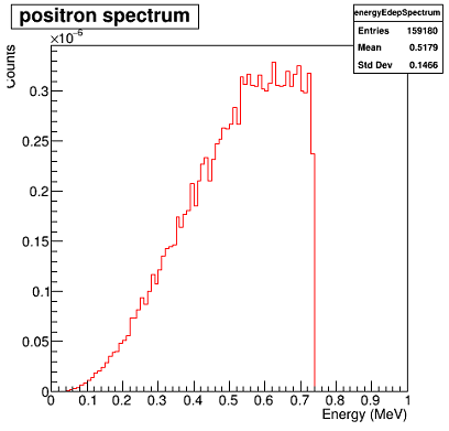

Sorry, I should have been more specific about what I needed. I want to grab the positron energy, but not only that, I also need the probability for each of the energies. Something like this graph here:
Is there a way for Geant4 to do that? Track the counts?

Do you want the positron energy distribution or the energy it deposits in some volume since your plot save EDep? I’ll work with the former for now.
There are two main ways. The more standard and involved one is record relevant information for every event in an ntuple and then process afterwards to generate your histograms. A cleaner, but less flexible, option is to have geant fill the histogram(s) as the simulation runs and then to just output/save the histogram into a file format of your choice. Very small file compared to listmode data option. To get the statistics you will just run many particles and then divide your histogram by the total counts.
This is covered here in more detail. There are many examples, but the most comprehensive direct example that has both that comes to mind is RDecay02 (this link goes to its histomanager class).
