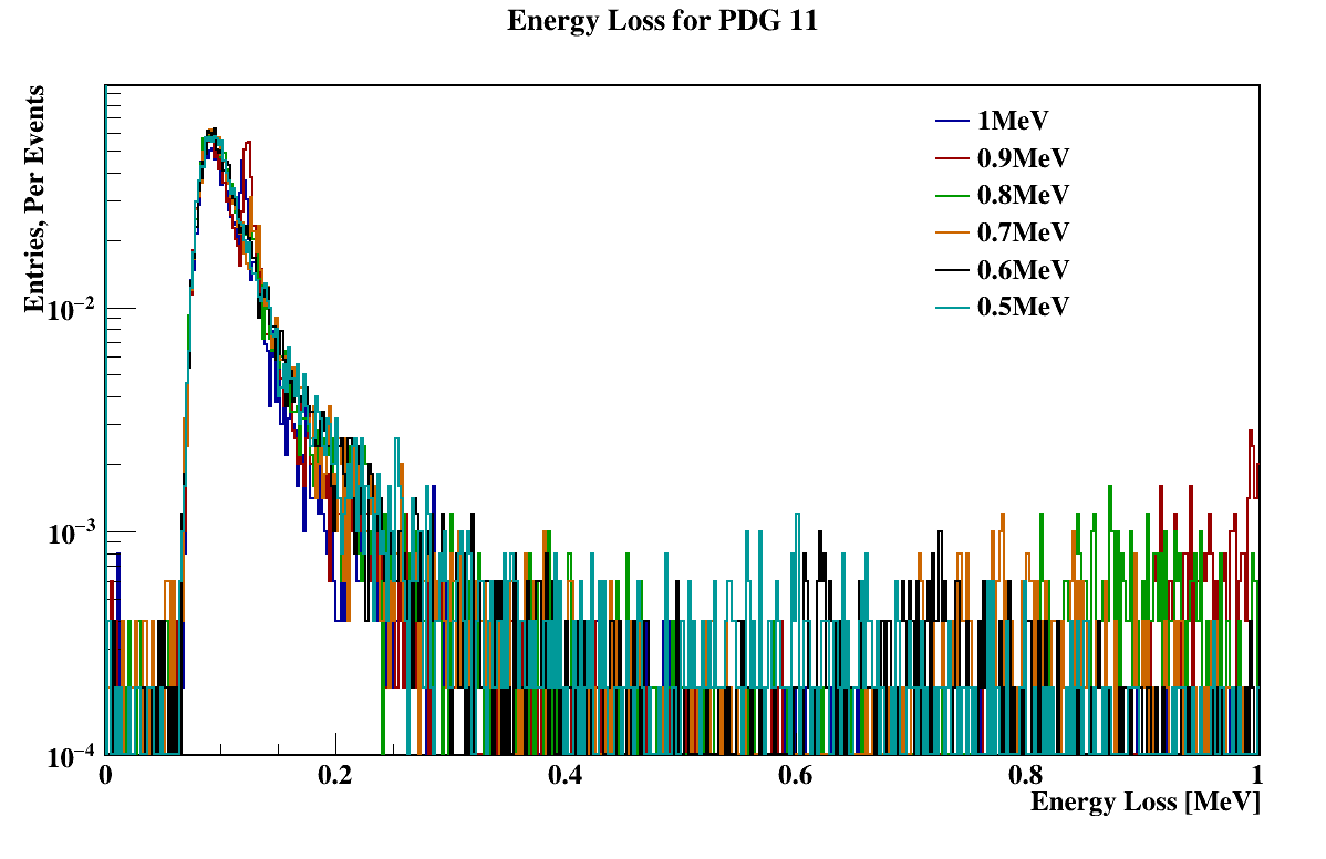

I am transporting the Ni ions on the Ni target through Geant3 and Geant4 and comparing the energy loss distribution for the Delta electron generated from a target and given a MC point on the active silicon sensors of thickness 320 microns.
Below you can see the Geant 3 and Geant 4 settings I am using in the macro:

I have produced the energy loss for the delta electron both in Geant3, see image below (Left histogram for Geant3 ),
It follows the Landau distribution, but
I see that at 0.12 MeV or 120 keV, there is a peak appearing, and then again following the trend.
However, in the case of Geant4 (Right Histogram), in all cases of EM model, emStandard, EMV, EMX, EMY, EMZ it follows the Landau distribution and there is no peak at 0.12 MeV or 120 keV, which is the case in Geant3?
So my question is, why is there a peak in Geant 3 at 0.12 MeV? What is the physics behind it, or is it an artifact of the model being used in Geant3?
Another thing which I would like to understand in the case of Gean4 is that
At 1 MeV, incase of the EMV (blue color) and EMX(Red color), there is a sharp peak and then a drop. However, in the case of the Standard (Black color), EMY(Green color), EMX(Orange color), if you look at them, then at 1 MeV there is a peak and then a kind of step function behaviour and then drops.
What is the reason behind it, and why is it not happening in EMV and EMX ElectroMagnetic process models?
Is it related to the electron-positron annihilation?
thank you.
