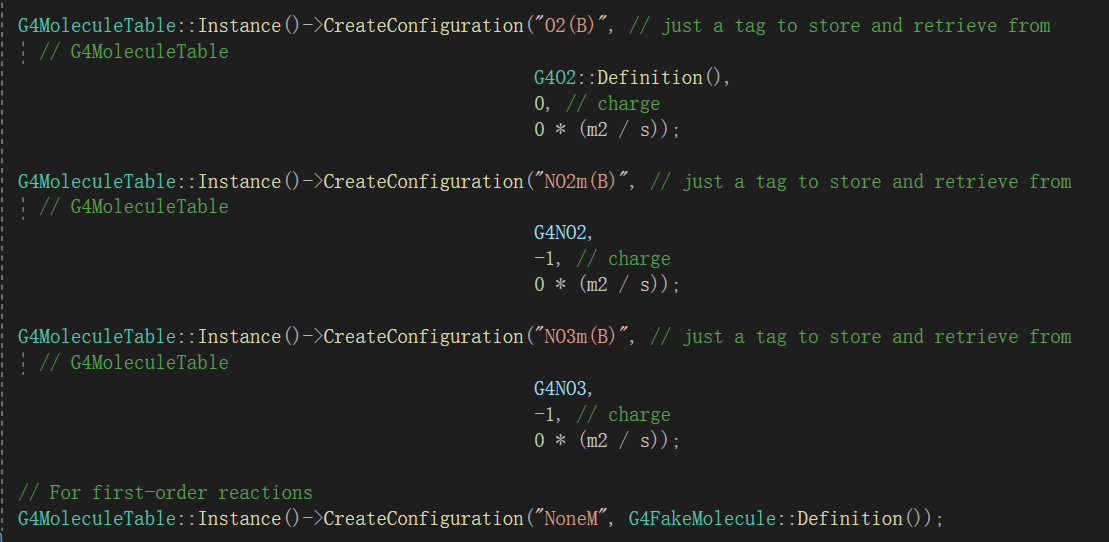

The first thing is that while inspecting the ConstructMolecule function in EmDNAChemistry, I noticed some molecules with no diffusion_coefficient that are marked as just tags. What’s the meaning of these tags? How these tags work?

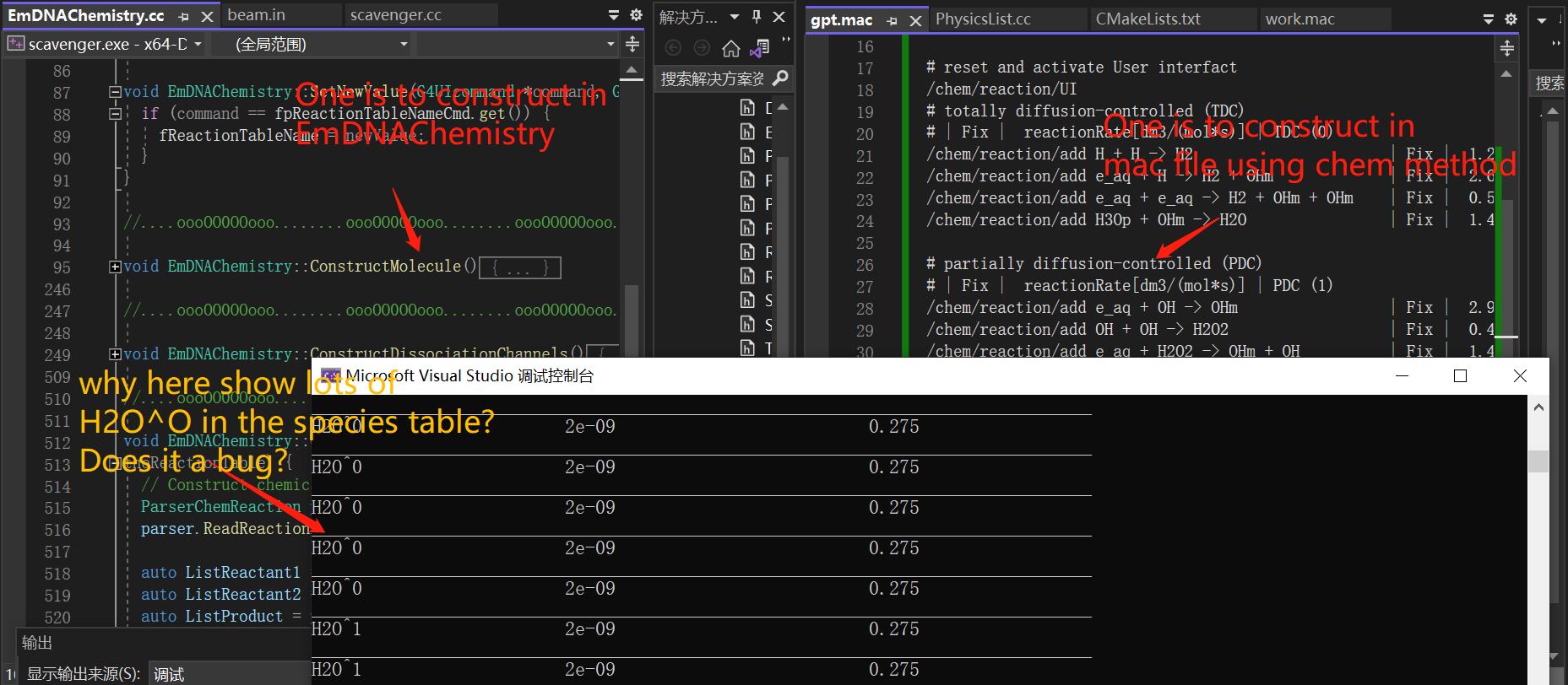

The second thing is that I want to construct the kinetic model of chemistry. I find at least two way to construct it.Does it have the same effect to the different ways? And why there are some moleculars with no diffusion_coefficient?

Scanverger example uses IRT model. And for now, this model defines a scavenger as no diffusion_coefficient molecule. In fact that, this scavenger is defined as continuum then we don’t need diffusion_coefficient. Please, find more detail in : Redirecting
