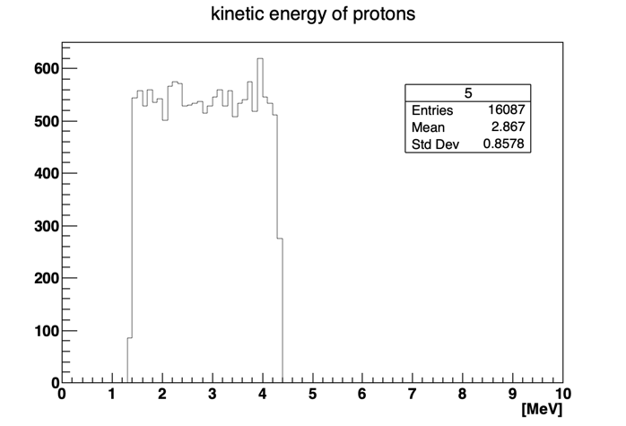

The 10 MeV neutron was used to boom lithium 6 target with 3 inch height and 3 inch diameter, the energy deposit by the proton event by event is shown below:
the key codes are:
if (aStep->GetPreStepPoint()->GetTouchable()->GetVolume() == fTargetVolume)
if(aStep->GetTrack()->GetDefinition()==G4Proton::ProtonDefinition()
G4double energy_deposit = aStep->GetTotalEnergyDeposit();
G4double step_length = aStep->GetStepLength() / 10.;
// 发光效率系数为:1.903MeVee/MeV
// Birks系数为:26.03g/cm2/MeV
// ej-309的密度为:0.96g/cm3
G4double fluorescence_energy = 1.903 * energy_deposit / (1 + 26.03 * 1.e-3 / 0.96 * energy_deposit / step_length);
event_action_->Add_Energy(fluorescence_energy);
Maybe the cross section of Li6(n,p) is wrong?

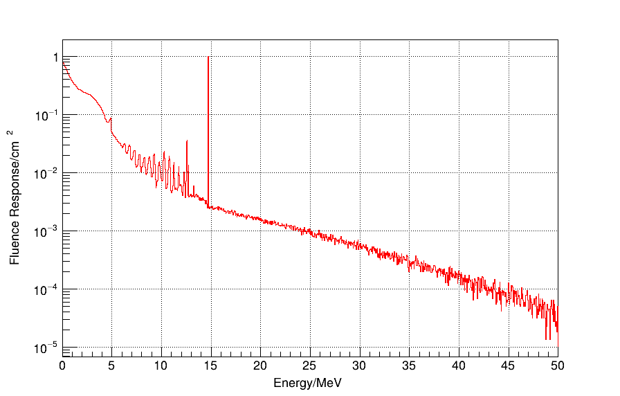

Here, a run of example Hadr03.
According to the printout, the cross section of Li6(n,p) is ~1.6% of 664 mbarn = 10.6 mbarn.
the proton spectrum is shown.
siyuan.mac.txt (386 Bytes)
siyuan.out.txt (4.7 KB)
The proton energy from Li6(n,p) reaction is too high, it disagrees the energy conservation.

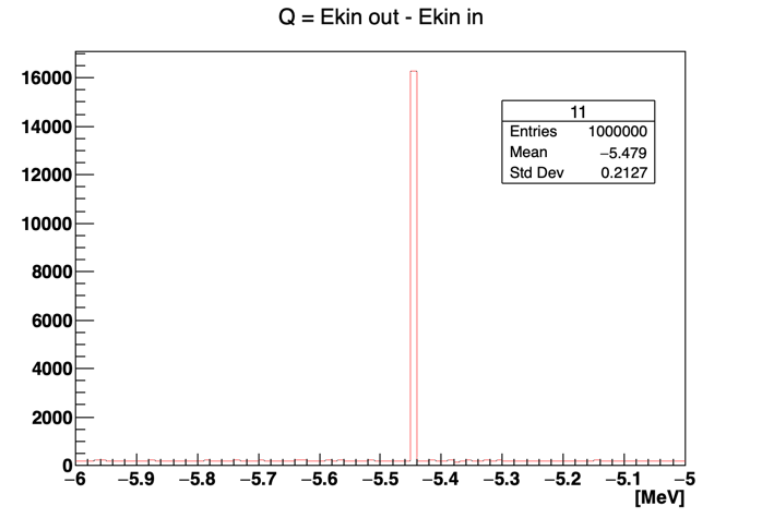

Here, a “zoom” of Li6(n,p)He6 channel. All the 16087 events are in the peak Q= -5.449 MeV
Therefore (totEkin)out = proton + He6 = (totEkin)in + Q = 10 MeV - 5.449 MeV = 4.551 MeV
I do not see any energy violation in these events.
siyuan.mac.txt (426 Bytes)

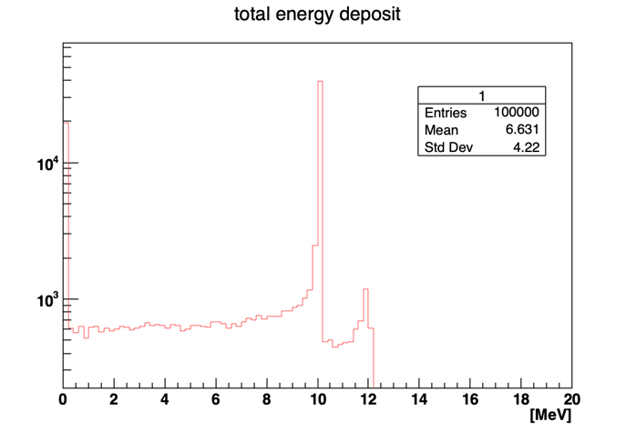

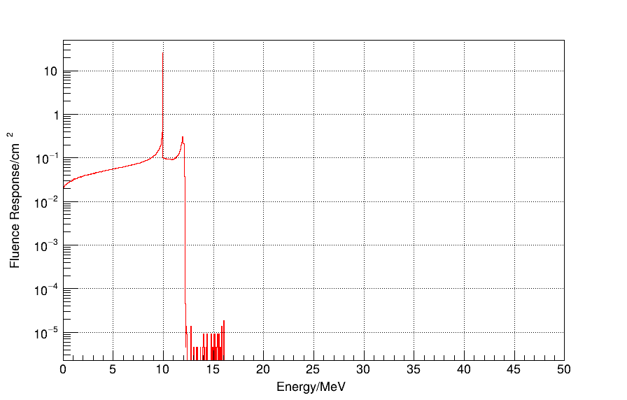

@maire1 , according your opinion, maybe something is wrong with my codes, but now the lithium 6 changed for hydrogen, and the total deposited energy is tallied, the result for hydrogen is:
this result seems right.
and the result for lithium 6 is:
why so much high energy deposited is tallied in one event?

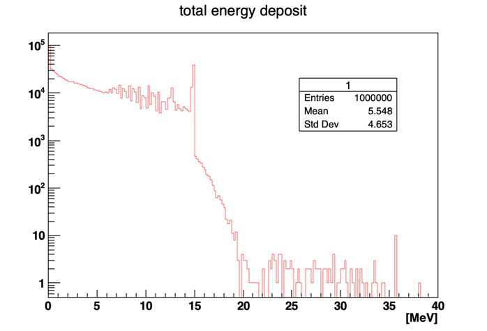

Here, a run of example Hadr06, and the plot of total energy deposit for Hydrogen and Lithium6
siyuan.mac.txt (608 Bytes)
siyuan-Li.out.txt (21.9 KB)
