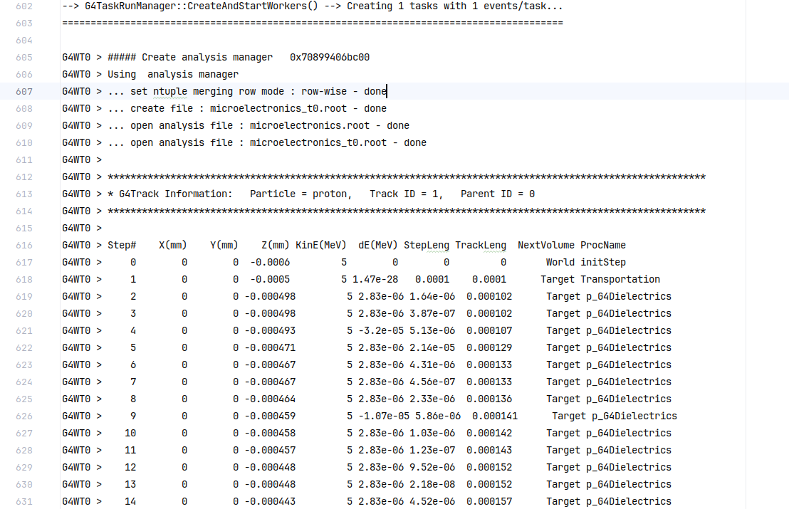

I think the dielectric process should dominate for low-to-medium energy heavy ions. However, when incident carbon ion energy drops below 10 MeV/u, virtually no secondary electrons (SE) are observed in the target, indicating the ion’s dielectric processes may not be activated successfully.
Furthermore, the output log file indicates that protons with energies below 10MeV are dominated by the dielectric process in the target, confirming successful activation of the proton dielectric process, the output file is as follows. Considering that heavy ions actually use proton cross sections scaled by a factor, I do not understand why the dielectric process for heavy ions fails to trigger.
Figure 1 5MeV protons incident on silicon target (process name shown in the rightmost column)
