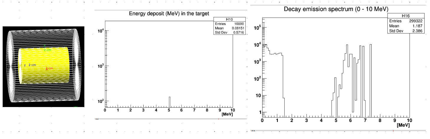

The target cannot record the decay spectrum correctly!
I am currently using the example of rdecay02. My geometry is set to the following style.
The yellow one is the LaBr3 detector and the white one is CsI detector. Now I am simulating the LaBr3’ internal radioaction. The radioactive source is Ac227. The following is my code to describe the uniform distribution of radioactive sources in the LaBr3.

However,the recorded data is not correct in H10.The decay emission spectrum is right.
