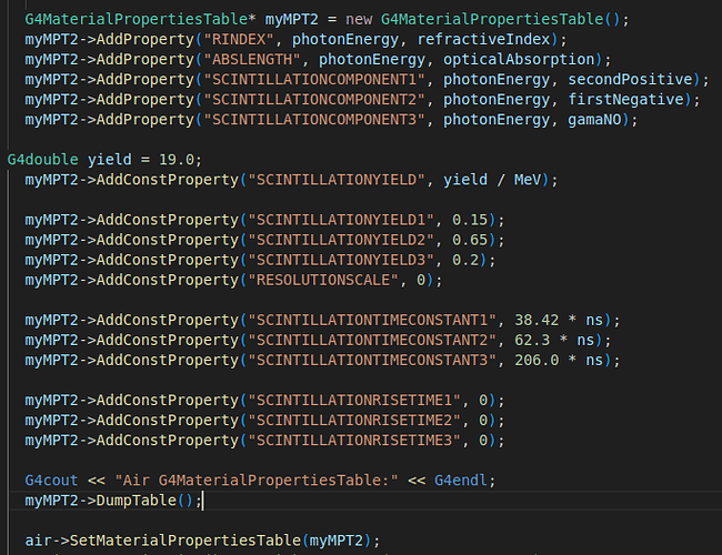

I am simulating a scintillation example : this is my code
the problem is on the prat : scintillationyield1/2/3
you can see that the total scintillationyield is 19/MeV , and the particle shot to air is alpha(5.49MeV) , this mean the “myPMT2” should produce 104 photons.

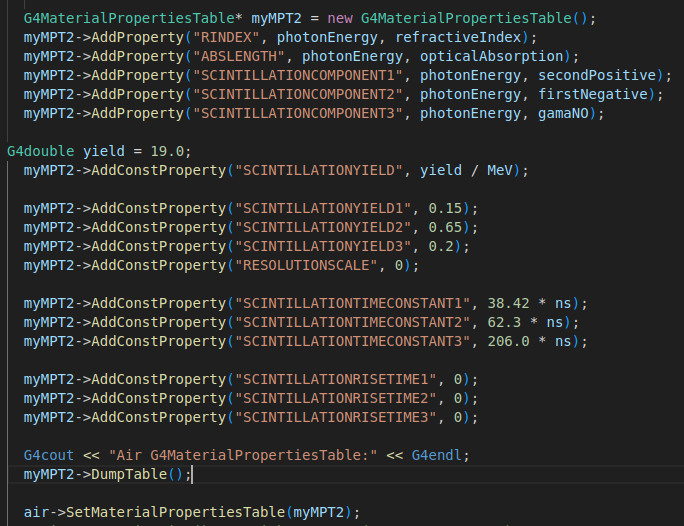

But if I annotating the code :
myMPT2->AddConstProperty(“SCINTILLATIONYIELD1”, 0.15);
myMPT2->AddConstProperty(“SCINTILLATIONYIELD2”, 0.65);
myMPT2->AddConstProperty(“SCINTILLATIONYIELD3”, 0.2);

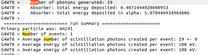

the photon yield is 104 ; if not ,the yield is only 28-32 ; when I change the value of scintillationyield1/2/3 ,the yield still is 28-32

i tried again
this is the result when i do not comment the scintillationyield1/2/3
this is the result when i comment the scintillationyield1/2/3
