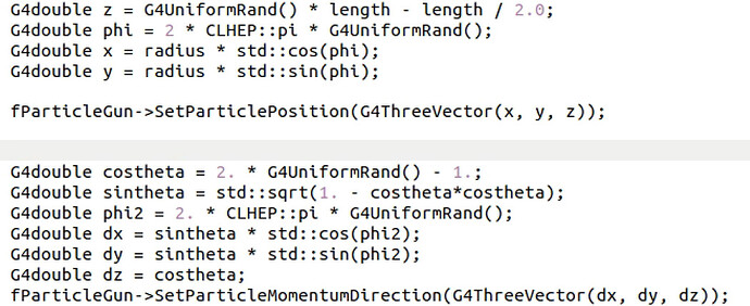

Thank you for your reply.The ParticleGun does not have any commands for “isotropic mono neutron” so I wrote the code myself to implement this feature.
Mmm. Perhaps you should let us see your code. For example, an isotropic distribution is uniform in cos(theta), not theta. To be safe, use G4RandomDirection.
Thank you for your reply.ok,This is my code.

G4double z=4UniformRand()*length-length*/2.0;*
G4double *phi=2**CLHEP::pi *G4UniformRand();
G4double x=radius *std::cos(phi);
G4double y=radius *std::sin(phi);
fParticleGun->SetParticlePosition(G4ThreeVector(x,y,z));
G4double costheta=2.G4UniformRand()-1;
G4double sintheta=std::sqrt(1.-costhetacostheta);
G4double phi2=2.*CLHEP::pi *G4UniformRand();
G4double dx=sintheta *std::cos(phi2);
G4double dy=sintheta * std::sin(phi2);
G4double dz = costheta;
fParticleGun->SetParticleMomentumDirection(G4ThreeVector(dx, dy, dz));
Looks OK. Did it make any difference?
Actually, apologies, I meant to recommend G4RandomDirection
fParticleGun->SetParticleMomentumDirection(G4RandomDirrection);
is all that’s needed for direction.
fParticleGun->SetParticleMomentumDirection(G4RandomDirection());
Thank you .Do I just change this?
