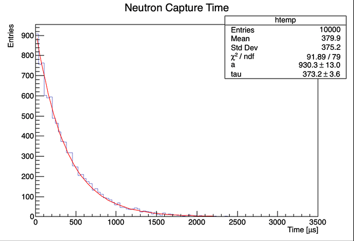

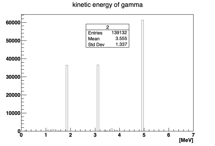

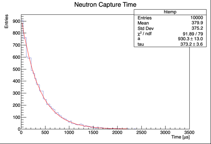

I am running a simulation where neutron are generated in a liquid scintillator (LAB) and I am looking at the energy spectrum of the emitted capture gammas as well as the neutron capture time.
For H, the energy of the gamma looks correct and in good agreement with NNDC data base. However, for capture on 12C the energy spectrum has peaks that should have very low intensity with respect to NNDC data base. Moreover, the capture time is ~400us where it should be around 200us for neutron capture in liquid scintillator.

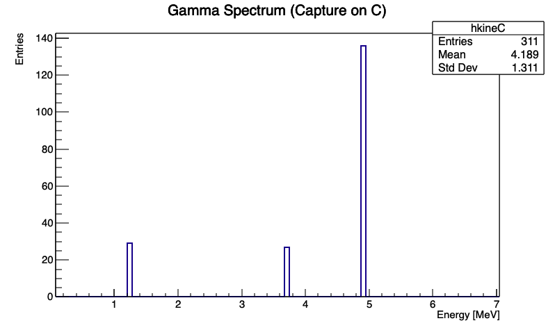

Hi @atolosad
Thank you for your reply! I tried using QGSP_BIC_HP (without NuDEX), and the neutron time is now correct but the energy spectrum for 12C is not.

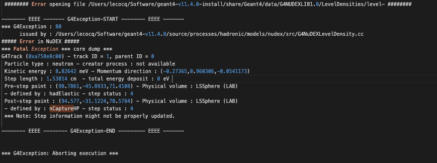

I am now enabling NuDEX, but an error is raised because it cannot find the correct file in LevelDensities. What version of G4NUDEXLIB is required for Geant4 v11.4.0? I am using v.1.0 that I downloaded here: Download Geant4-11.4.0 - Geant4

Hi @atolosad
The library is correctly listed in the datasets. However, I get this error:
If you have any idea on how to solve it, I’d greatly appreciate it.

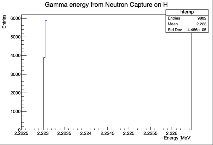

Hello @atolosad,

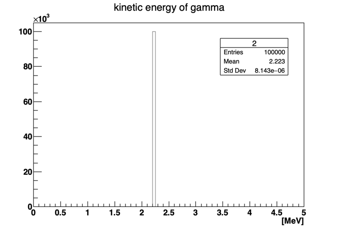

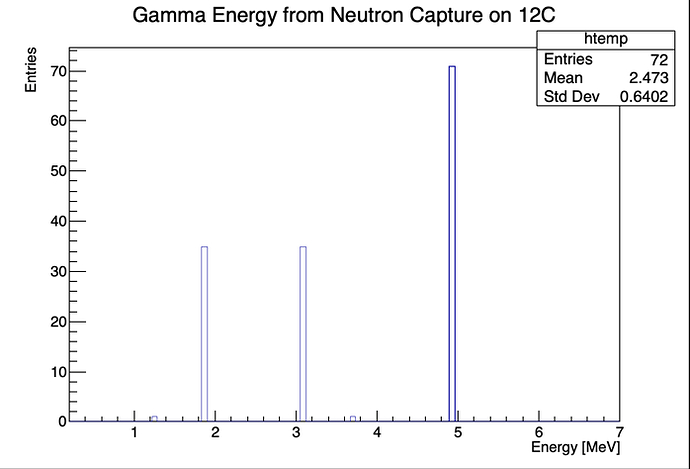

I have made several tests to correct the wrong gamma rays from the neutron capture on C and found a new interesting behaviour. Using G4HadronPhysicsQGSP_BIC_HP, I changed the NeutronRadCaptureHP builder to NeutronHPCapture, and I get correct emitted gamma rays for neutron capture on C12:

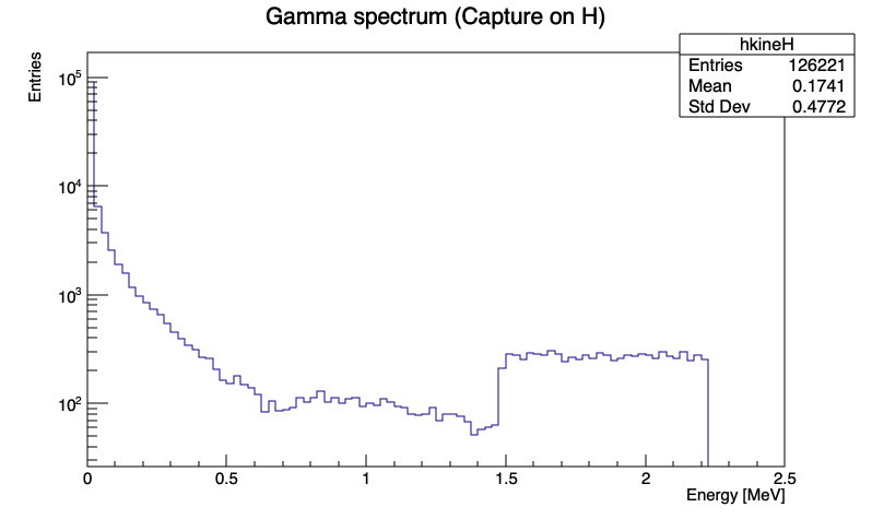

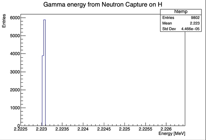

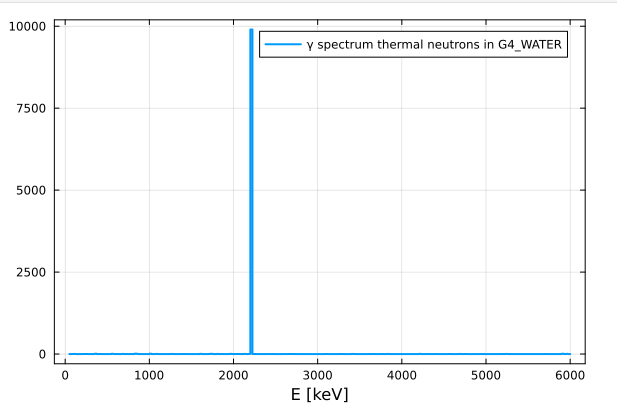

However, if I am looking at the energy spectrum of the emitted gamma from the neutron capture on H with the same setup, I get a continuous spectrum instead of a ray at 2.223 MeV:
I found a similar report here: 2660 – Drastic neutron capture gamma changes in version 11.3.2
I was wondering how this behaviour can be corrected?

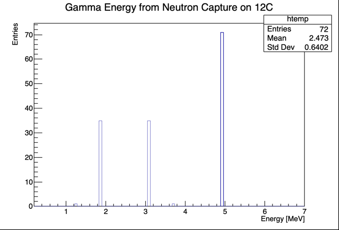

Here, a macro for Hadr03, results for H1 and C12, and plots.
jeff.mac.txt (411 Bytes)
jeff-H1.out.txt (3.2 KB)
jeff-C12.out.txt (3.2 KB)

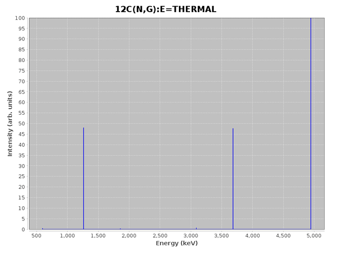

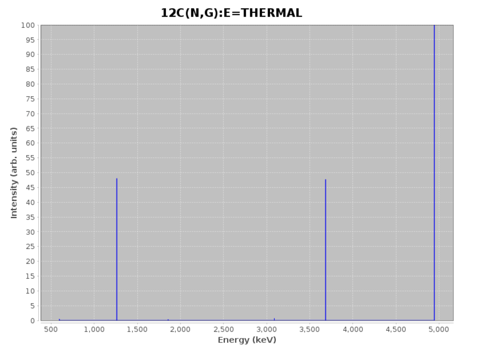

Hi @maire1,
Thank you for this message! I am attaching the spectrum from NNDC:
The gamma rays are a bit different. Am I misunderstanding something?

Comparing NNDC and G4 I notice the following regarding gamma transition (in keV):
4095 (into G.S emitting 4095 full) <-- seems OK
1856 (into 3089 which decay emitting 3089) <-- both too intense in G4
1261 (into 3684 which may decay emitting 595+3089 or 3684 full) <-- not enough of both
Looking at the corresponding C13 entry from the Geant4 datafile. The 12C(n,g) level `(4946.33 5)` (parenthesis from ENSDF) is missing. So the entire population and emission is handled somewhere else. I have to see in more detail
/Pico

Hi @Matthieu_Lecocq , how do you fixed the n-H gamma emission? I’m having the same issue using 11.4 and nudex, however it seems also related to the physics list QGSP_BIC_HP. Using another physics list, for example Shielding_HPT produce the “expected” output for neutron captures on hydrogen. The problem is that nudex is not working for this physics list.
Thanks in advance for your feedback.

Hello again,
Looking at the code, the work around I found is editing the: G4NUDEXLIB1.0/KnownLevels/levels-param.data
Specifically the line for 2H and just set a value higher that 3.22 for Umax. This removes the warning: “No level density and level scheme not complete … Ecrit = 0 MeV … MaxExcEnergy = 3.22457 MeV“ and just produce a single gamma with the correct energy. Now there is new warning: “############## NuDEX: WARNING, there are no thermal capture for ZA=1001 , with Sn = 2.22457 ##############“ but it seems to work.
Maybe the developers can fix this ”bug”?
