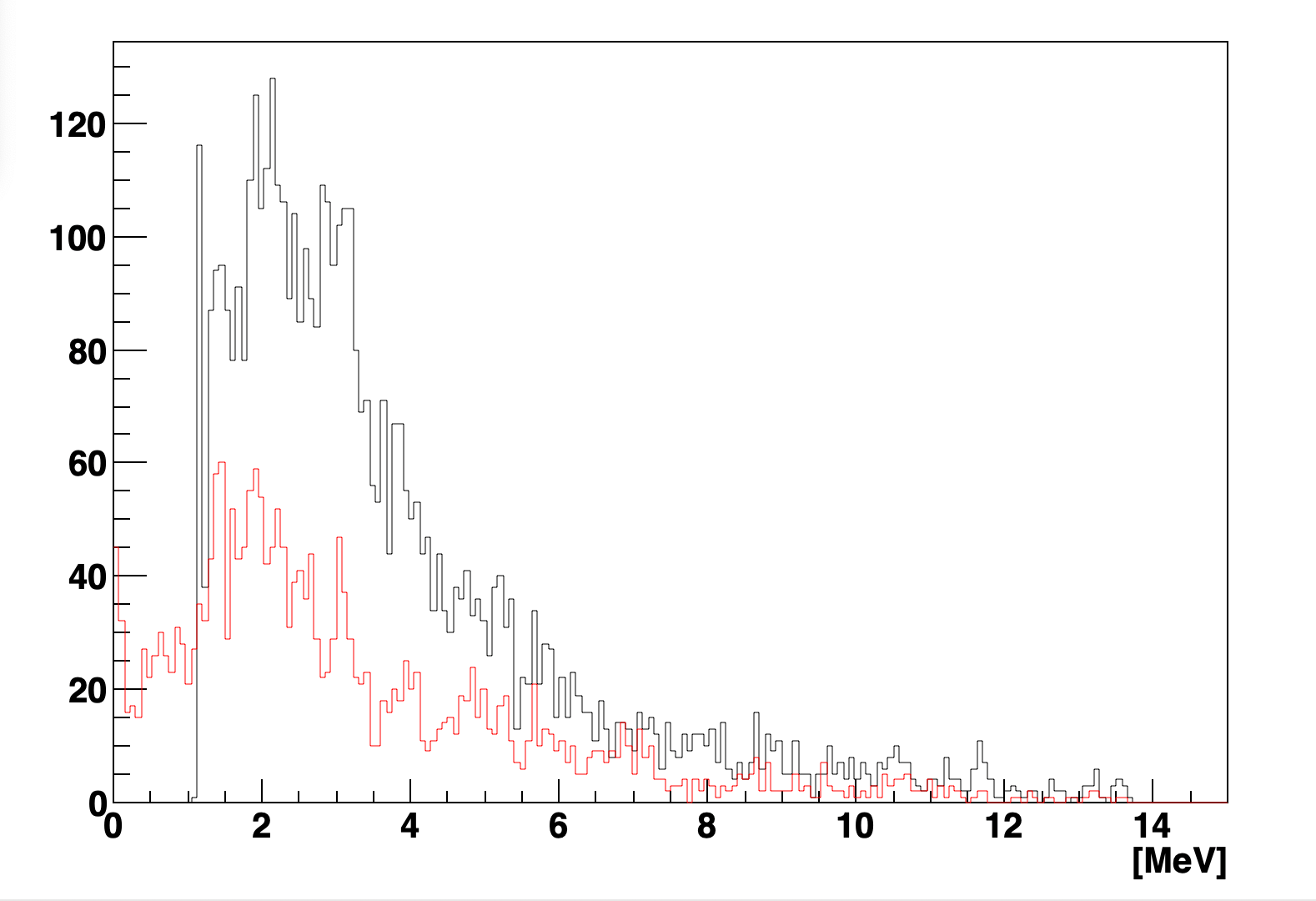

I’m trying to moderate a primary neutron distribution only to around 1 MeV (not fully thermalize it). I have just modified example Hadr04 to modify the geometry and scoring.
Geometry is an isotropic neutron source with custom energy distribution; generated neutrons pass through a 10 cm thick D20 moderator and finally histogram the KE of the ones that reach a virtual detector. The world volume and virtual detector are made of G4Galactic.
Unfortunately, from the below output spectra, I only think the neutrons are getting absorbed and not moderated (like the peak does not shift).
Any help is highly appreciated to just shift the peak of my initial neutron distribution without too much absorbtion.
Black - original distribution; Red - moderated distribution
Hello @kitu.utkarsh ,
I think it would be useful for you to explore the verbosity of your simulation using something like /tracking/verbose 1 in your macro file and confirm the processes that your neutrons are going through. Run your simulation with low statistics but with “high” verbosity.
/Pico

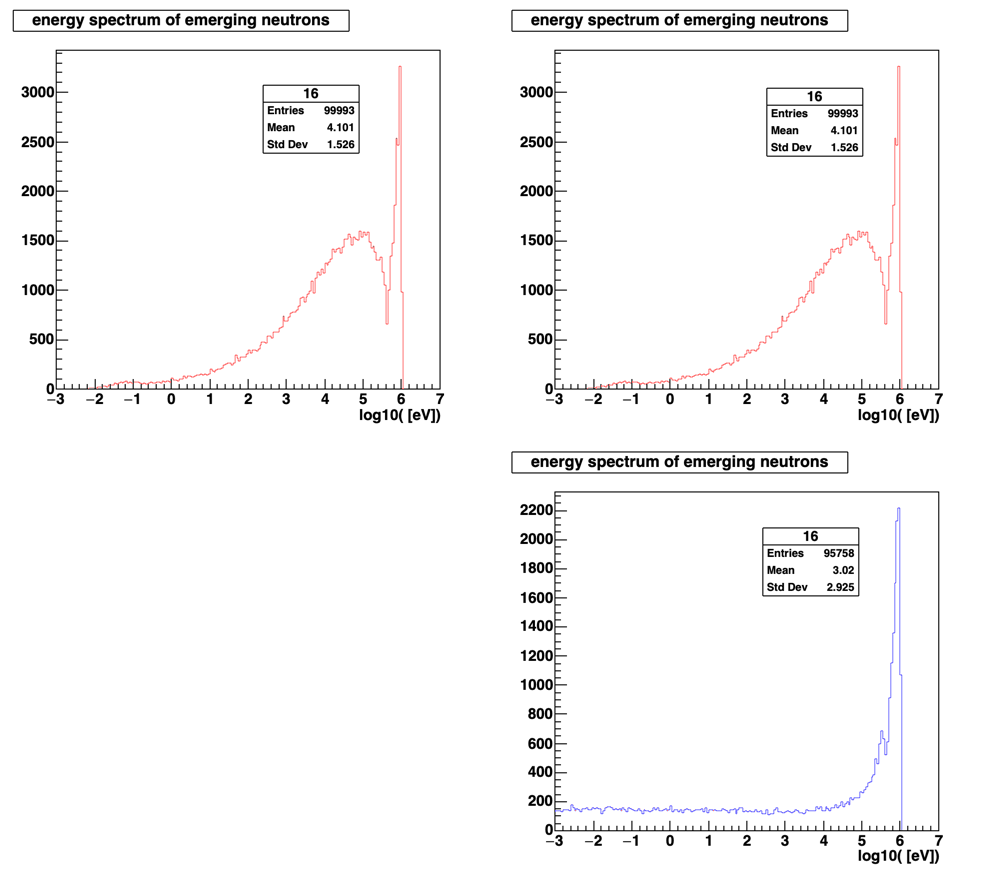

To confirm your observation, here a macro for example Hadr06.
An isotropic, mono energetic (1 MeV) neutrons source at the centre of an heavy water sphere (radius 10 cm).
Plots of emerging neutrons, for 3 different HadronElasticPhysics constructors : local-HP (left), G4-HP (right), G4-XS (bottom). The conclusion is simple: use HP
ps. In PhysicsList::SetCuts(), to save time, put cut for proton = 10 km
kitu.mac.txt (704 Bytes)

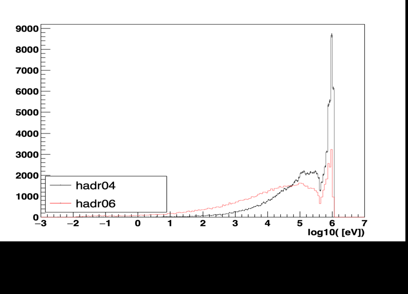

Thanks a lot for sharing these, and sorry for the delay in getting back.
I basically compared the above plot with the Hadr04 example that I am working with. The spectrum looks fairly close, though the second low energy peak is quite shifted between the two examples. Do you have an idea of what is causing this behavior?

Hello @pico
Thanks a lot for your suggestion. I’ll try increasing the verbosity and see what’s happening to individual neutrons inside my moderator.
1- In Hadr06, the neutron source is at centre of a sphere of 10 cm radius.
in Hadr04, to be comparable, choose a thickness of 20 cm
(or, in hadr06, radius of 5 cm …)
2- NeutronHPElastic model already “moderate” neutrons.
ThermalScattering is a refinement which is applied only on neutrons below 4 eV
It can be time consuming. In your case, I guess it is not necessary.
