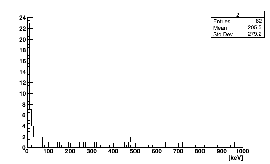

I am simulating a background of neutrons from rock so I am using as an input to G4 the energy spectrum of these neutrons in the laboratory. Firstly, I am interested in seeing the energy deposited in the neutron detector filled with He3 gas in the absence of shielding. I could achieve this using maybe a point source but things change when I sample positions and directions from cavern walls as I do not see any peaks as one would expect from thermal neutron interaction with He3.
I attach the energy spectrum that I get when I use a macro
neutrons.mac.txt (2.6 KB)
. Can you please suggest the possible reason. I attach the macro that I use. Could the problem be with my macro?
Physics list is QGSP_BIC_HP.
I realized that I incorrectly assumed that I could define surfaces in any orientation of my choice and the positions of my plane were incorrect as they did not allow particles to be generated from the walls. Briefly, the problem is with my macro.
