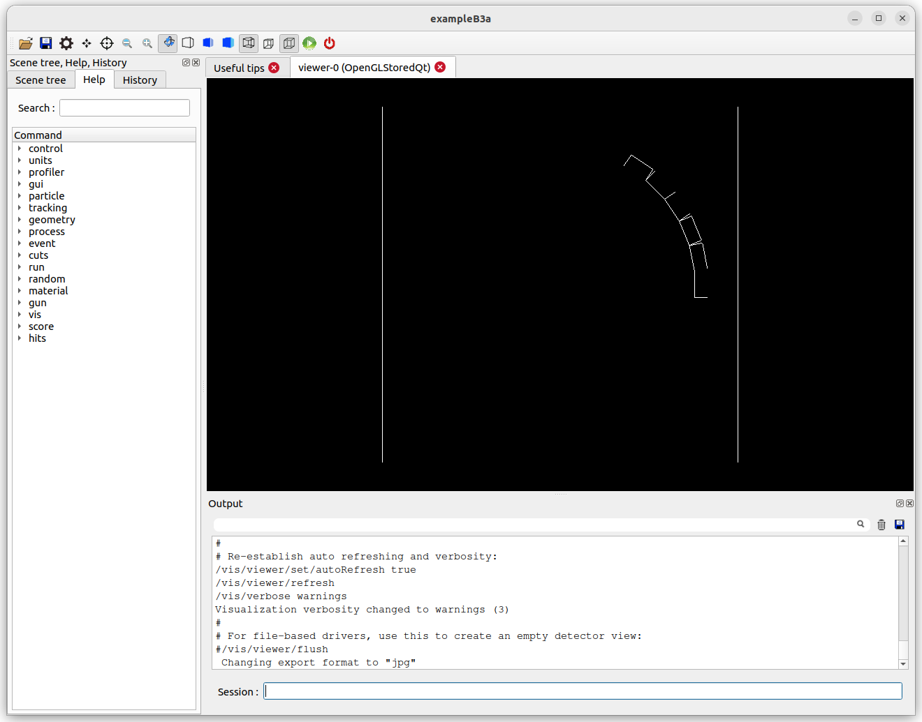

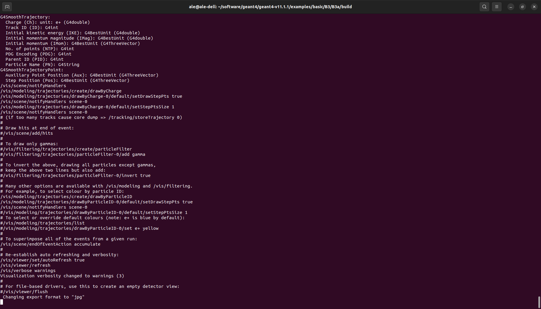

Hello.
I have a problem displaying the geometry of the examples.
Example B1 runs perfectly but when running B3 it runs but my PC freezes and does not show the geometry
I have a Ryzen 7 5825u, 16gb ram and Ubuntu 22.04 lts

Mmmm. Make sure you have the correct driver for the graphics card.
It solves it by installing ubuntu 20.04 instead of the 22.04 that I had and now it runs perfectly.
thank you so much
Good to know you’re up and running, Alejandro. Thanks for telling us.
I don’t use Ubuntu myself, but I think others also seem to be having problems with the latest Ubuntu.
