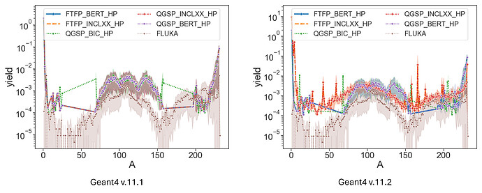

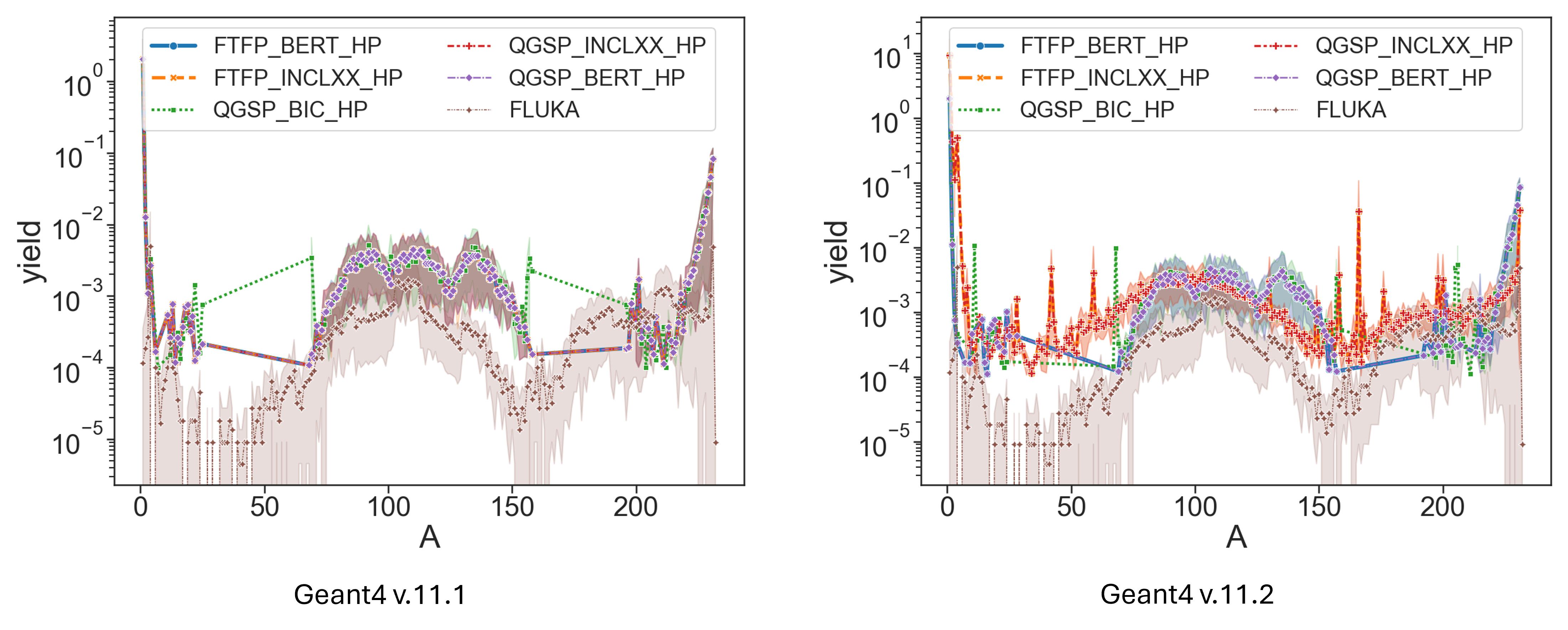

Therefore, I would expect the distributions to be identical across all physics lists in versions before v11.2, and to be split into two types (one for FTFP and one for INCLXX-based physics lists) in v11.2. Below are the distributions of atomic mass numbers of nuclei produced in the “CaptureAtRest” process for different physics lists in Geant4 versions v11.1 and v11.2:
I ran the simulation for each physics list and Geant4 version with the same initial random number seed. From the distributions I showed, I would conclude that the cascade model has some effect on the hFritiofCaptureAtRest process, even if it isn’t explicitly called.
