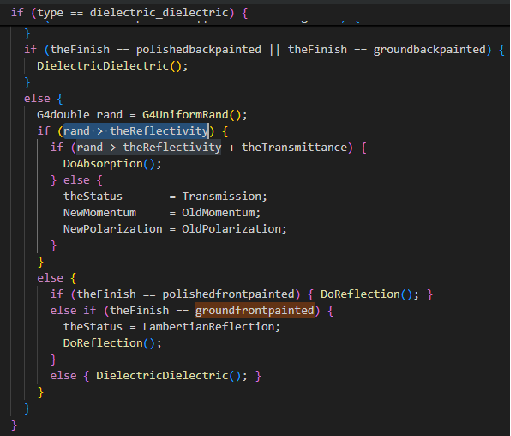

I don’t believe there is any protection against non-physical values. The code works by choosing a random number in the range [0,1), then comparing to the values for REFLECTIVITY and TRANSMITTANCE. It is likely that choosing REFLECTIVITY > 1 will be the same as REFLECTIVITY = 1. However, please don’t rely on that information. I would recommend to either pre-process your data so that values are physically meaningful, or verifying the behaviour is as you expect, for example with print statements or verbosity.

You are right! I check the source code “G4OpBoundaryProcess.cc”(geant4/source/processes/optical/src/G4OpBoundaryProcess.cc),it said if transmittance=0,choosing REFLECTIVITY > 1 will be the same as REFLECTIVITY = 1.
