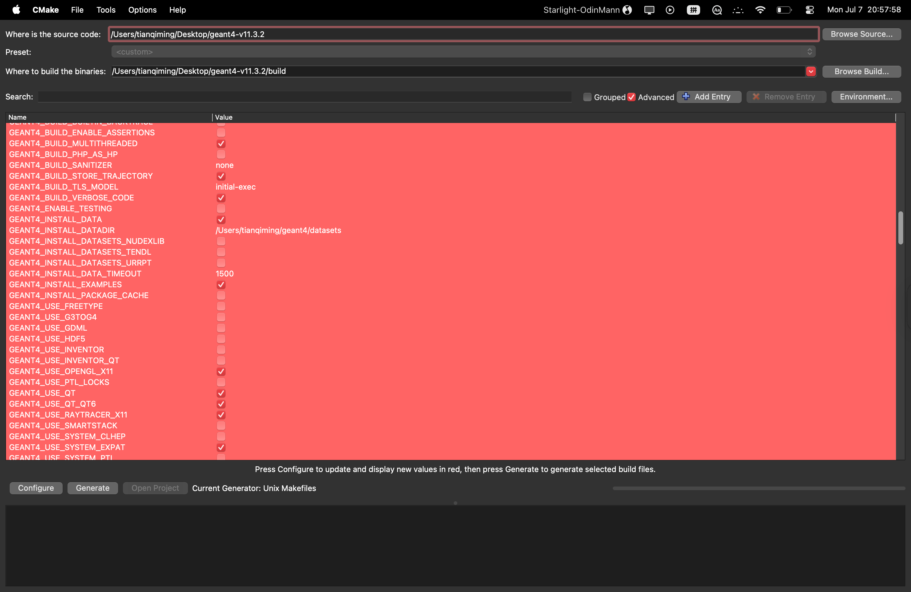

Hi! I’m using a MacBook Pro (M3 Pro) running macOS 26. I understand this system isn’t officially supported yet, but I just want to give it a try. I installed the external packages like Qt using “brew install” command on terminal, for the cmake arguments please check the attached screenshots.
Screenshot 2025-07-07 at 20.58.19|690x448
All I can suggest is turning off GEANT4_USE_OPENGL_X11 and GEANT4_USE_RAYTRACER_X11 as XQuartz/etc might be causing issues. I’d generally only recommend the Qt6 or VTK drivers on modern macOS.
