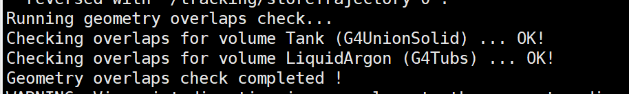

Thank you so much for replying me. And I’m so sorry for replying after so long.
I check for overlaps, and the output information is as follow.
