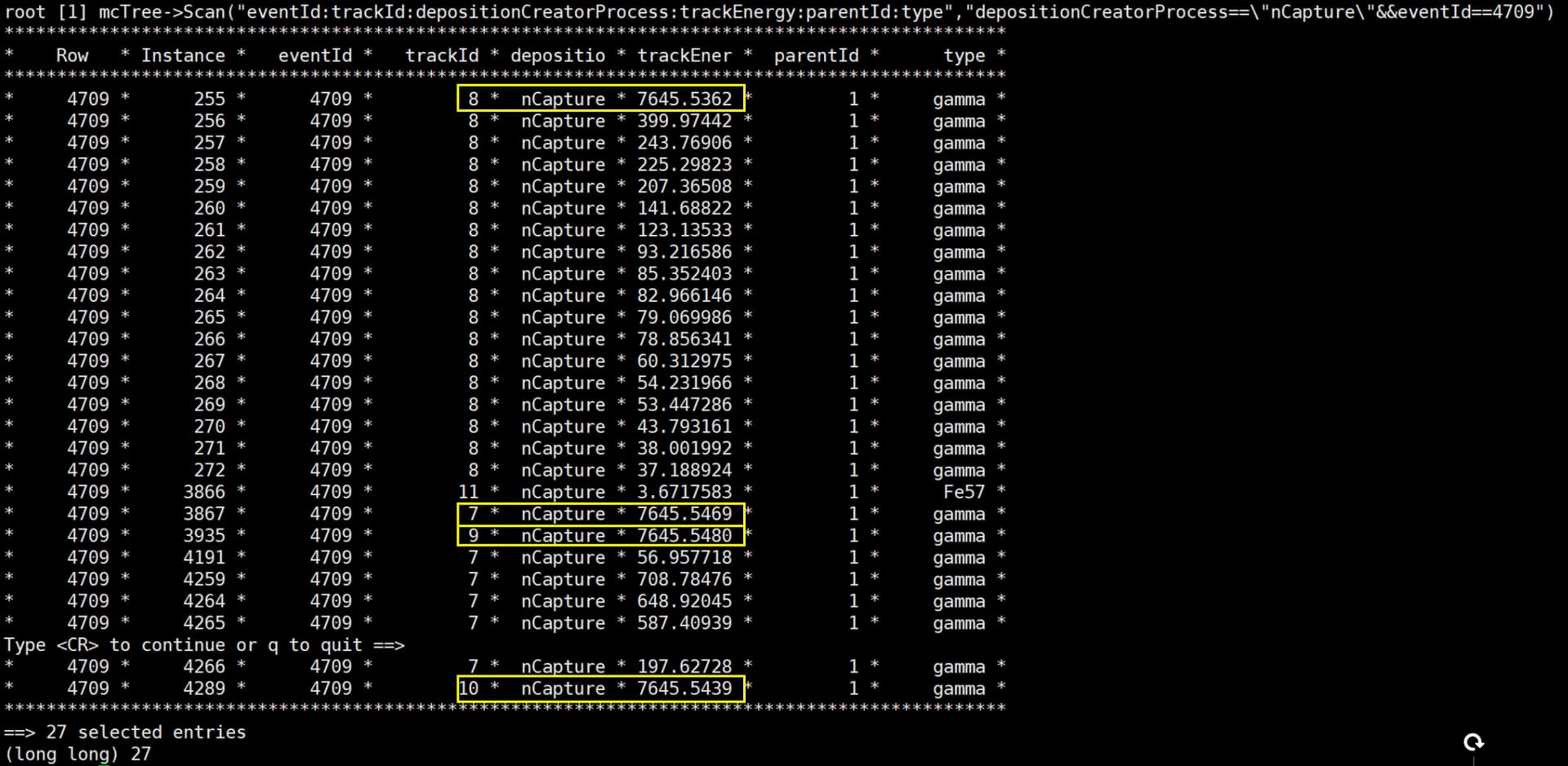

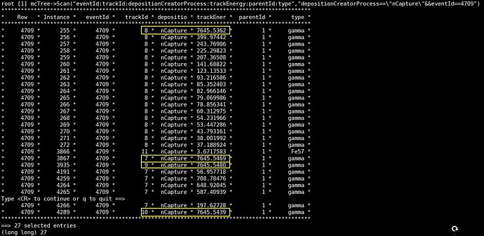

I record the deposition hit of each trackId.And part of the result are as follow.It indicates that there are four 7.6MeV gamma rays comes from the same parent.

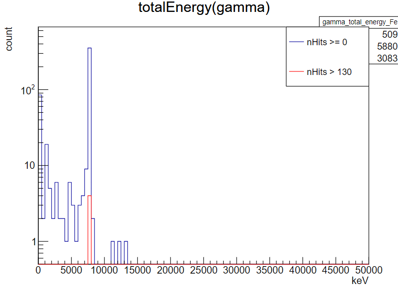

This makes the phenomenon I mentioned earlier resolved.(I want to simulate the process “nCapture” and record the following effects.)
But there are still existing the fact that the sum of gamma rays plus than 7.6MeV(from Fe56 capture neutron).
