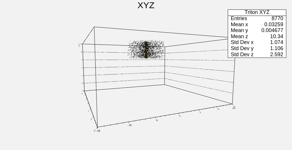

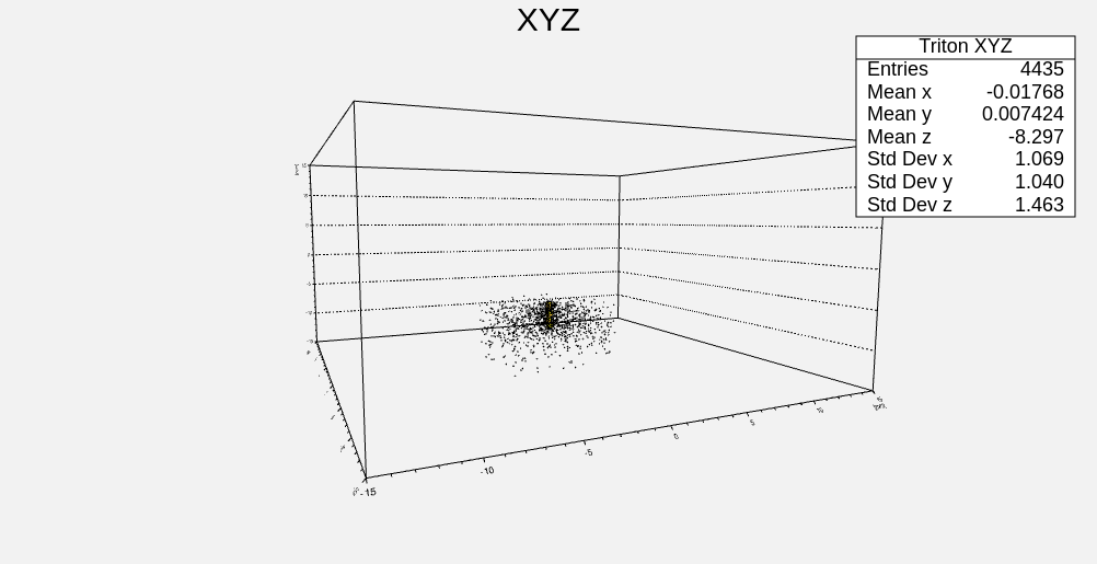

I have changed the ntuple id to be threadlocal with the idea that this would force that particular thread to have created through the analysis manager to create an ntuple that is merged with the rest at the end of the run, but this has made no difference.
The 3d histograms dont have this problem. here are the pics of two instances.

I just dont understand how using basically the same code the 3d histograms are succesfully made and filled yet the ntuples have these issues.
