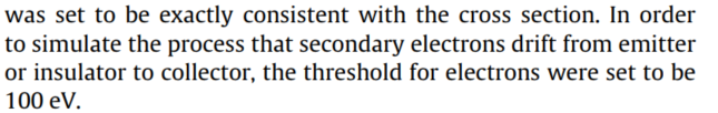

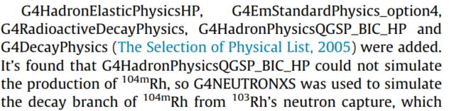

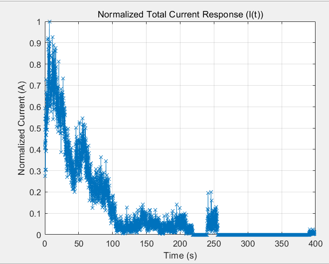

Thank you for your reply. I spent two weeks quickly getting up to speed with Geant4 and then simulated the example I uploaded earlier. Now, the results from my simulation don’t quite match the expected outcome, as shown in the two figures below. My initial analysis suggests this might be because the decay process is not being accounted for. However, the physics list I added is identical to the one in the example I provided. I’m a bit confused. Do you have any suggestions or insights?
Those specific details of (n,gamma) reactions are probably best described using the newly developed NUDeX dataset and corresponding physicslist. Please have a look at it here:

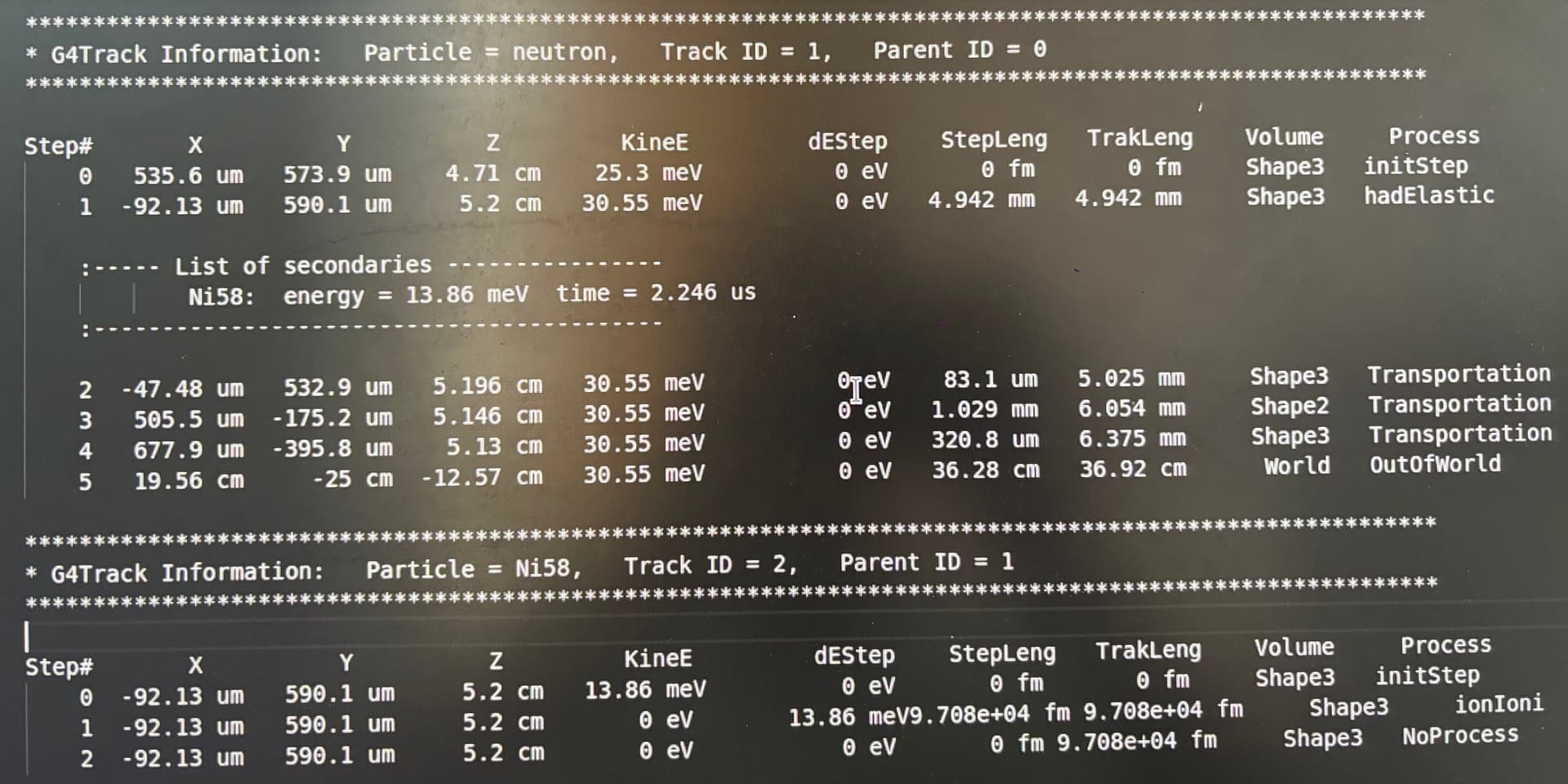

hello, While reviewing the Geant4 run log, I noticed that kinetic energy is not conserved before and after this hadElastic reaction. Surprisingly, the neutron’s energy actually increases. Could you explain why this happens?
Are you using ParticleHP in your physics list? Did you set a finite temperature for your target volume? If so, you’re seeing one effect of “Doppler smearing” – ParticleHP can take into account the thermal speed of the target atoms, so the nucleus can transfer kinetic energy to the projectile.

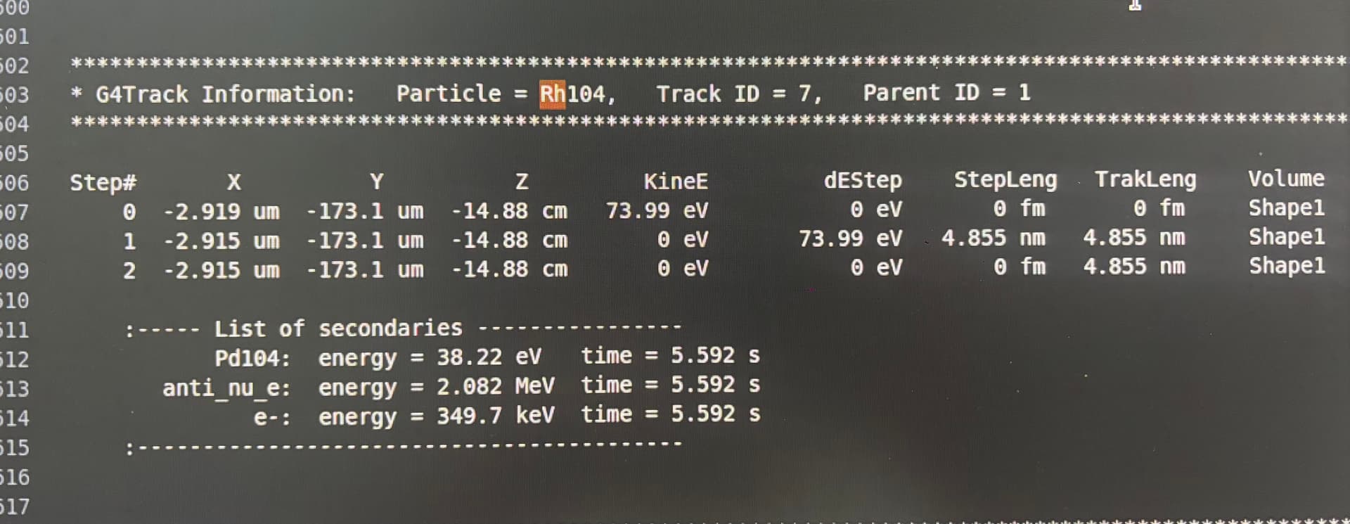

I’ve observed an unusual phenomenon: during the decay of Rh-104, why are no gamma particles produced, and why are no excited-state nuclides generated in the reaction process? Is this inherent to Geant4’s operational mechanism?
The printout is telling you that the beta decay was nearly to the ground stage of Pd104. Why would you expect gamma emission since the first excited state is at 51 keV? Both beta decay to the ground state and internal conversion, as a competing process to gamma emission, are low probability but nonzero likelihoods. It is chance you caught one.
Also to avoid confusion later, subsequent x-ray emissions of the Pd104 nucleus are not daughters of the Rh104. They are daughters (secondaries) of the Pd104 or “granddaughters” of the Rh104.

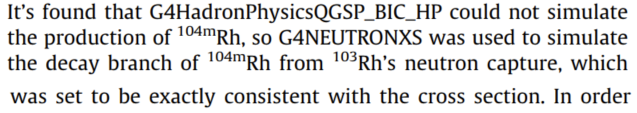

Could you tell me which physical process in the G4NEUTRONXS database is called to generate 104mRh? I’ve tried the following two processes but they didn’t produce it:
G4NEUTRONXS >20 MeV G4NeutronElasticXS
G4NEUTRONXS >20 MeV G4NeutronInelasticXS
Could you tell me if you know this answer, please? Thank you.
Did you see the phrase “neutron capture” in the graphical image you posted? I think you’re looking for G4NeutronCaptureXS.
Here, a macro for example Hadr03 and its printout, showing the production of 104mRh.
The production rate is rather small : only 326 104mRh for 10000 incident neutrons.
