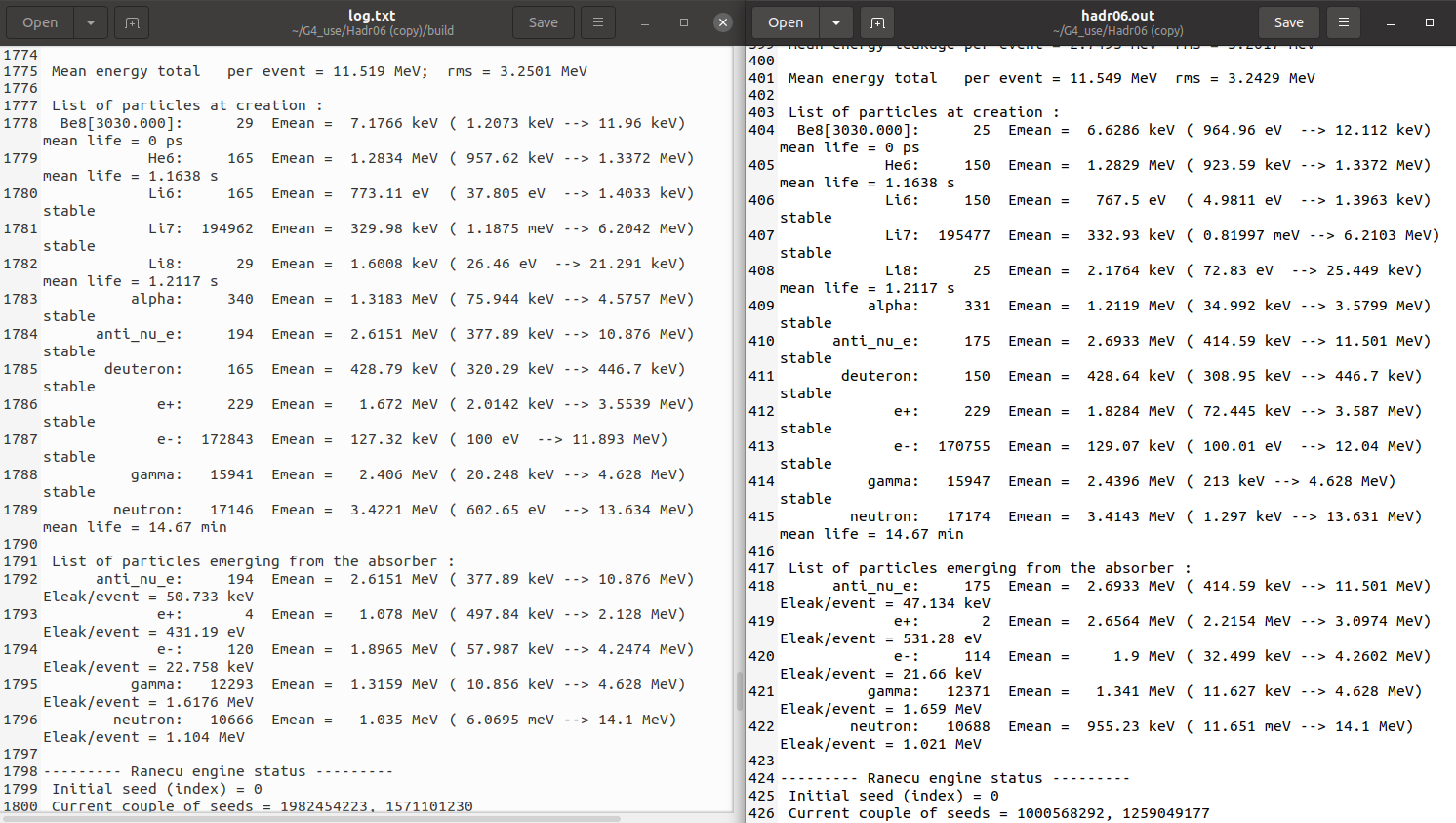

OK. We will do an other test. Install example Hadr06 and compile. Run macro hadr06.in . If the result is similar to hadr06.out (it cannot be strictly identical) your installation has a good chance to be OK.
So, how should I modify it, because in the first question I asked, the picture shows that the article author can generate 104mRh using G4NEUTRONXS,why?
